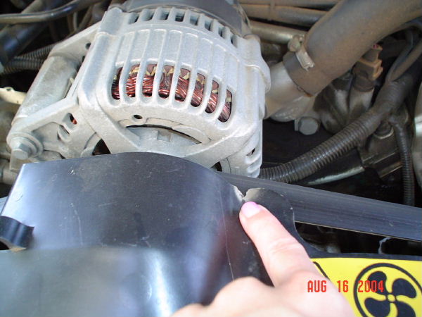

I changed my serpentine belt out about 8 weeks ago and I noticed that it is rubbing the fan cowl (see picture). Is this normal ?? Do I possibly have the fan belt on too tight? Maybe I need to release some tension? Could this be dangerous? Any thoughts? Thanks!! :help:
Melissa

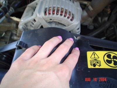

Another pic of the problem:

Naah.. just get dremmel or heat knife and cut it to not touch belt - i had to do it when got Mean Green alternator - no issues.
Did you have alternator reinstalled recently? I cant think of reason for it to touch belt overwise.

RoverChic, there is a problem and cutting the cowl is a bandaide solution. I'd sand down the sharp edge of the cowl but strongly suggest you take a closer look. Since you've only changed the serp.belt and not any pulleys or components, I'd take a really good look at how the belt is seated. There is the possiblility that the cowl was installed incorrectly too. The belt and cowl should never touch and if so there is something seriously wrong. You don't want to have the belt break somewhere far from home.

Is your croel the 2 piece type, if so make sure it is lined up properly, it shouldn't be rubbing.

PEOPLE ...Come on give me some credit here. I have been working on cars, rovers, just fixed the lawn mower, fixed the brush hog last week, for about 10 years now. The cowl is seated correctly.. :) :) :bootyshak
No Mike, the cowl is one piece. But from John's post it sounds like I am in emanate danger?? Oh well, its not like I have never been broken down before on the side of the road or at a truck stop (right Mike?). And I always carry an extra serpentine belt..Just in case. So then do I need to cut the cowl or just remove it all together?

Anyway - normally that molding thingy shouldnt really touch belt. Seeing how it was pushed onto belt (i assume white color is heat induced damage) - it would normally be either cowl sitting weirdly after something, or hood lining sagging and pushing it... If belt is ok (i doubt its sitting incorrectly.. or there will be lots of lovely noises, shakes & etc.. plus its very visual) - then i think you ok.. :)
Dont take cowl off btw. It helps cooling a lot.
