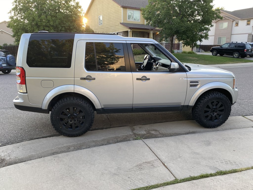

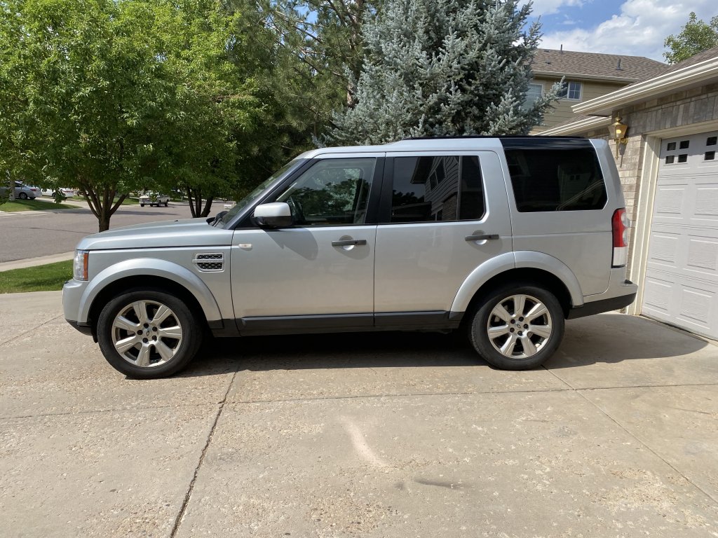

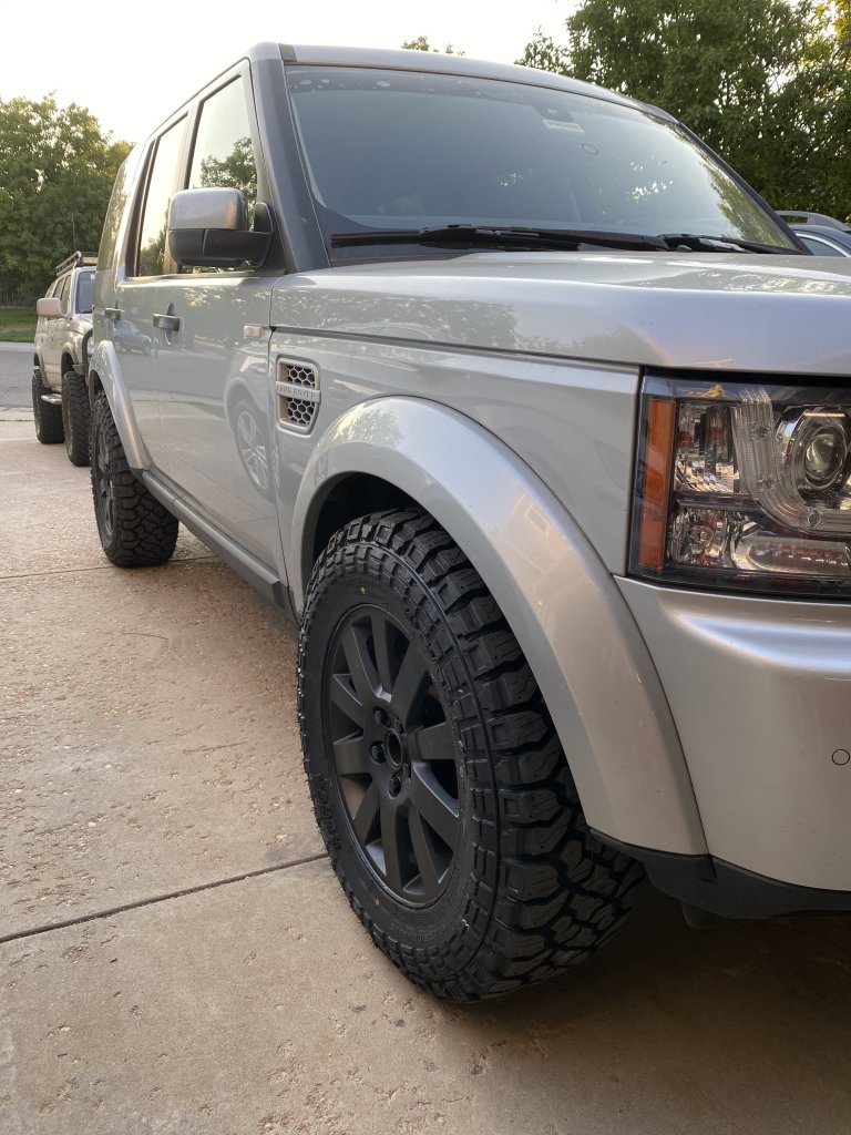

Finally got the wheels and tires swapped out last night. Ended up with the Kelver RTs and landed on 265/65/18. I really wanted to go bigger - and probably will - but got a great deal on these 265's so I figured I'd start here. It will be interesting to see how these Kenda's hold up. They are e-rated but I could find almost nothing about them online. Talked to a guy who had them on his Duramax and he thought they were holding up better than his BFGs. My duramax used to chew through those pretty quick so maybe that is a good sign. The BORA spacers are a work of art. Love that they are american made too. Fastened them with some Gorilla lugs - a huge upgrade from the stockers.
Need to add some height with the GAP tool and delete TPMS. Will probably get to that tonight. And just FYI...these tires would have rubbed on the frame horns for sure had I not cut them.
Next on the list is replacing these crossovers as preventative maintenance then I'll start ordering some armor. Should be all ready for Moab season this fall.
Before:
After:
