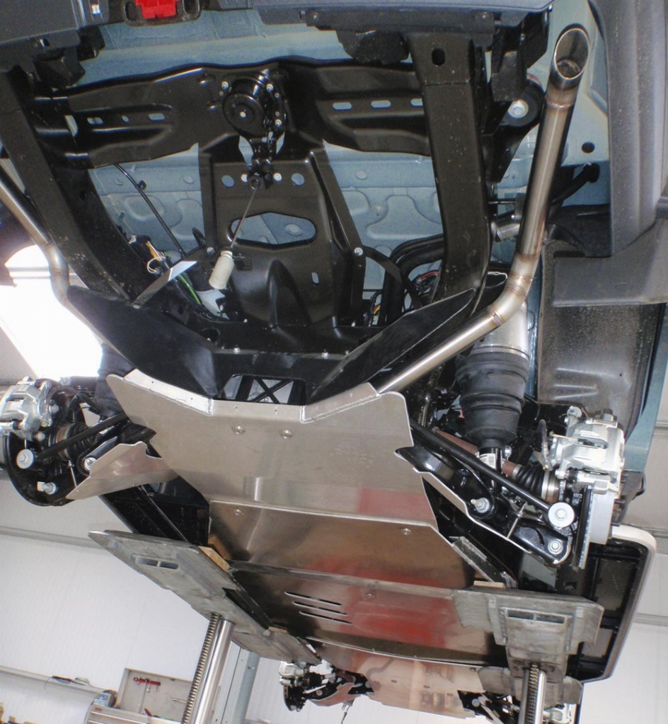

@avslash - I read that you were looking how to protect the exhaust...check this pic out.
I've seen that from Prospeed. If those pieces existed when I was doing mine, I likely would have gone that route to save some weight over the steel pieces I have now. Not worth it to me at this point to spend the money, though.
I always thought those control arm guards are interesting. They look cool, but I am not sure I have ever heard of someone breaking an actual arm. Strut mounts, yes, but not the actual arm.
The Asfir rear diff plate provides some protection to the exhaust, as well.
What I would really like it to either find a way to reroute those pipes (which I have been unable to do) or find some kind of flexible, compressible tubing to splice into each exhaust line. Something that could stand up to a temporary compression on a rock or other obstacle and then rebound into shape. I have thought about braided stainless with appropriate couplings, but I haven't gotten around to experimenting with it yet.
I will need to find the pic...but there is an instance where the prospeed center skid came down on a rock that was hidden by water on a drop and completely dented in and they had to cut the bolts to get it off...I think the steel is a better option regardless of the weight.
