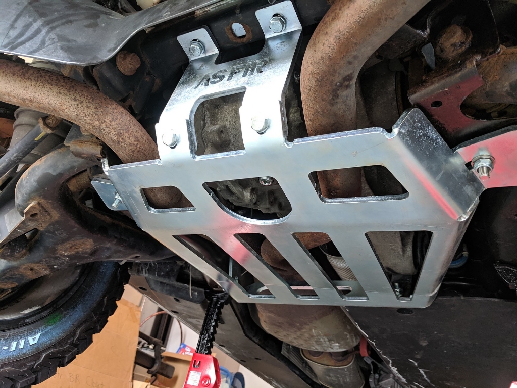

The Asfir rear diff plate provides some protection to the exhaust, as well.
That thing is a serious piece. It's nearly 30 lbs and a pita to put on or remove but I figured it's worth it. The annoyance occurs when you have to do anything requiring access to the axles or tie rods.

Also, as far as skids.. The Tactical 4x4 stuff is super stought... probably overkill.. but great for sliders, gas tank skid and transfer case. I just put the ASFIR rear diff (And exhaust pipe) guard on and I like it. Good fitment (although I did have to cut the T44 gas tank skid a bit because it shares a bolt with the asfir). Its pretty light weight also. I kinda wish all my skids were that light.
Those damn exhaust pipes stick down below the suspension arms in the rear...

4- I have the same looking Asfir gaurd and a note to people, it probably is a simple direct bolt-on for stock exhaust but if like me you have a Magnaflow.... it is not simple... 23 bends to the guard and stainless washers stacked as spacers off those 2 widest mount points finally allowed a fit with no contact even when hot or bouncing around off road. It's hard to bend that thick steel with very little leverage but the 23 times was marking it up, then start the various bends, test fit, mark more, remove, bend more, etc, etc, etc. What a PITA but it finally came together. Due to the custom fitting and such it's no fun to remove and reinstall for rear axle work but I bet it'll do it's job one day.
