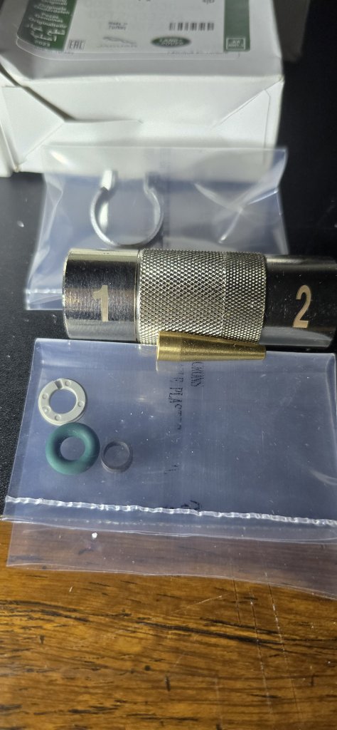

So I order this set of fuel injector seals for a company called LRJM PARTS from eBay since there suppose to sell OEM Land Rover parts but no matter where I look I haven't fought a single black Teflon seal online would and I trying to decide if I should use them or send them back and just order New Fuel injectors since I'm just replacing the Valve Cover Seals any advice would be helpful as I don't want my truck cathing on fire

The new Teflon seals have to be "sized" when installed.
There's a tool for that procedure.

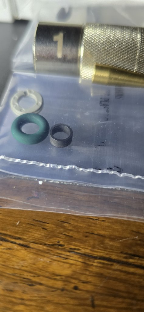

I have the tool but my paranoia is about this kit because in all the kit I see the seal are white for and blue for the top the that kit I have the seal is black for the bottom and green for the top I'm just checking the see for others who have done this if that's normal or if they may not be legit

Those parts will work.
On the 4.4L V8s, the Teflon seals are black also.

Okay then will they will on my 2011 5.0L V8 LR4? Which is what I'm worried about as the company sent me this when I gave them my specific model year, engine number.

I think what Rover Range is saying is that there are other LR's that use a similar color injector seal. If you arent comfortable with them because of the color, return them and get different ones. I used these on mine when I did the valve cover gaskets:
Not JLR OEM and its been fine and has not burst into flames yet.
