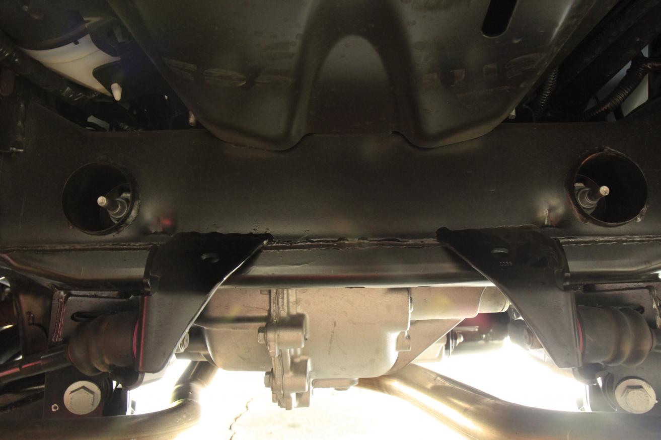

I chose to lop off about a ¾" wedge of the steel bracket on both sides which was digging into the tire tread. This helped a ton. I can keep the tire at 25 psi and carry a pump. It seems like if that bracket was re worked, one could put more rubber up there. I mean we all cut and weld things anyways right? What's a tie rod bracket for anyways? :stupid:
Not sure I'd recommend this to others but its what I did. I doubt the little bit of metal that was removed compromises integrity of the bracket.
I'm running the Compos and BFG 265 65 18.

That size tire doesn't usually require any tricks though.

I just didn't feel comfortable keeping tire at 15 psi and risk loosing a bead. Keeping it at a higher psi makes me feel much better and it still comes down with ease.

Yes, I meant that size did not require any deflation in my experience, just removal of the fiberglass shield.

Removing a heat shield should be the only things you should do to fit BFG 265/65/R18 under a truck. If the spare is brand new it will be a tight fit. I deflate my spare to 7-8 PSI. and then have no problems winching it all the way up. It will not go up by itself like OE full size spare , but you will have to tilt it so the front part of the wheel/ tire is up first and then the back. It may need a little kick so it is all the way up.
