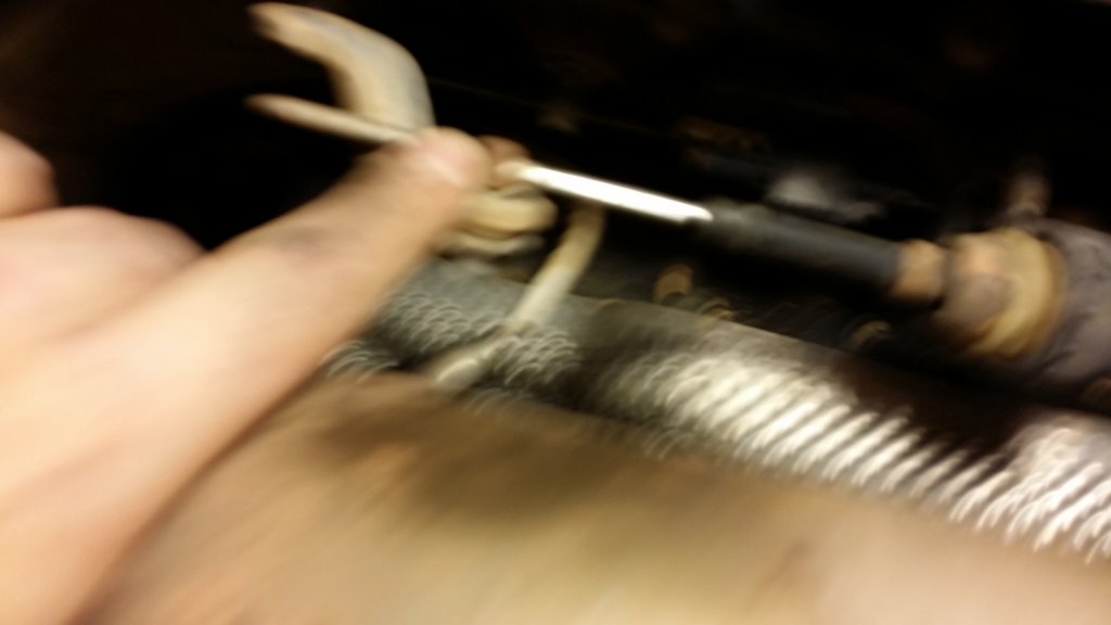

I replaced my entire gear selector cable on my LR3, but I did not have to replace the bushings on the shifter linkage attached to the transmission itelf. Having been down there, it seemed like a fairly simple piece and thus, a farily simple repair. The only shot I got was blurry, but my finger is on the pieces you linked to on ebay and AB. The shifter cable goes straight through it - thus when you move the gear selector in the truck, the cable retracts and moves the linkage piece attached to the transmission.
It is possible something is just binding up the shifter cable as well - so crawling underneath and looking for mud or debris would be the first step. If someone else can be in the LR4 moving the cable while you look you may be better able to see where the issues is stemming from.
