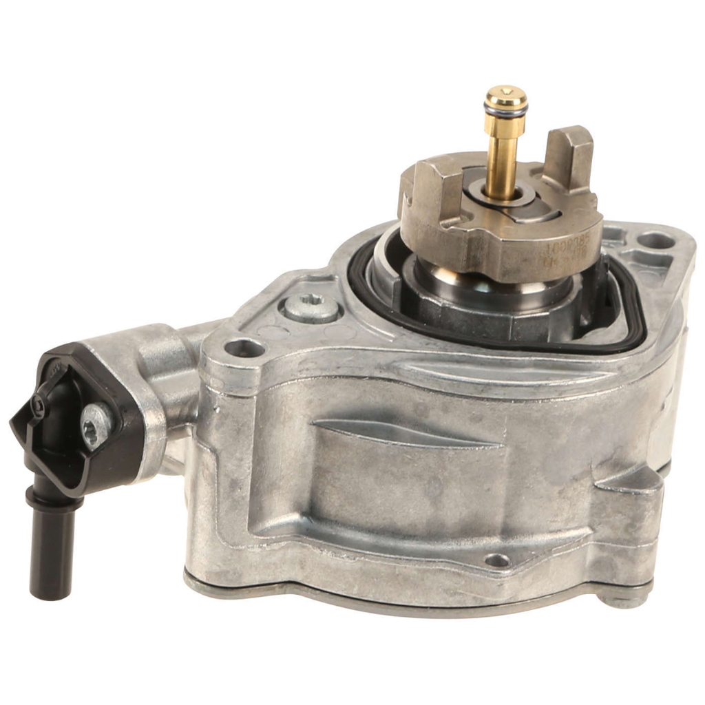

New design, this is what you want:

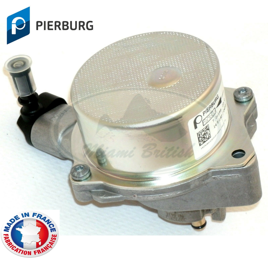

Old design, don't buy one of these:
