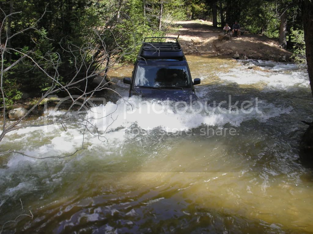

Here's Matt taking it to the limit on one of the Great Divide trails in CO. My favorite deep water picture. :cool:

One of the things that saved me in the crossing in Boaz's picture was the design of the airbox. The intake on the side of the car is actually lower than the entrance to the airbox. As a result, the water has to travel uphill before it would get into your engine. Though my intake was submerged in the crossing (the picture isn't of the deepest part), it was only momentary, thus I was fine. My biggest worry was that my intake was on the upstream side....

Boaz - what trail is that? Pretty awesome!

That is called the Half Moon Trail, just outside of Leadville, CO. A group of us did the trail on the GD4 this year. The water wasn't as high during the GD4 as it was when I took that picture in the spring during a Sollihul Society run. My very favorite water crossing picture for sure.

There is a north and a south halfmoon. That looks like the crossing just after the trail splits and heads up North halfmoon. Been camping up there. Got snowed on July 4th! But have never seen the water that deep!
