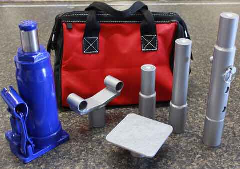

A buddy of mine uses the safe jack bottle jack with a secondary bottle jack to allow for extended heights. He has the Tactical sliders with the nerf bars and runs Johnson rods. Works well but pricey. ImageUploadedByTapatalk1443143814.637898.jpg

I have a bottle jack but I don't typically carry it. (I was ignorantly confident in the Hi Lift which with my setup - no after market jack points - was not as easy as I had imagined.). Next Spring I will consider Tactical 4x4 sliders again. And the suggestions here are helpful. I do need to figure out how/where to place the X Jack. Given how it balloons out I was afraid it would out too much pressure in the wrong places.
