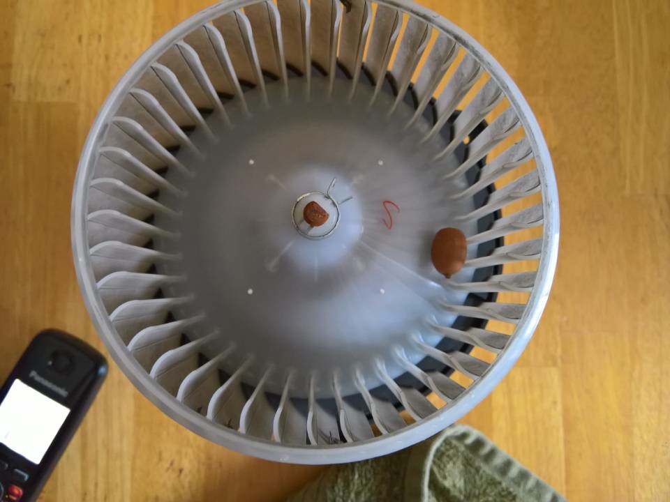

I did my research
the official standard is to remove the glove compartment first, which REQUIRES a special tool 501-113
I checked some video from youtube on LR3 model, which seems not necessary to completely remove it
I checked the LR3 and LR4 repair manual about the blower part, which are almost exactly the same
so my guess is I can follow the LR3 video to do the same thing on LR4
better safe than sorry , I would like to get yours 2 cents before I start
Thanks
jackkyxu
Feb 25, 2016
119
never mind
got it off without removing the glove box
but just need to remove the kick panel
I found the Official repair manual is a garbage
this video really helps
and I found this
I really do not understand that oak nut could get in

Squirrel! Just hope they don't knaw your wiring harness.
Rodents filled the airbox of my daughters Audi, but with her dog kibble
I now put moth balls under the hood when leaving for a few days. Just returned from a rodent research center in NM where they leave all vehicles with hoods up.

harness is good
i am confused that how they get in since there is little room between the blower and the cabin air filter, etc
moth balls may be a good idea
