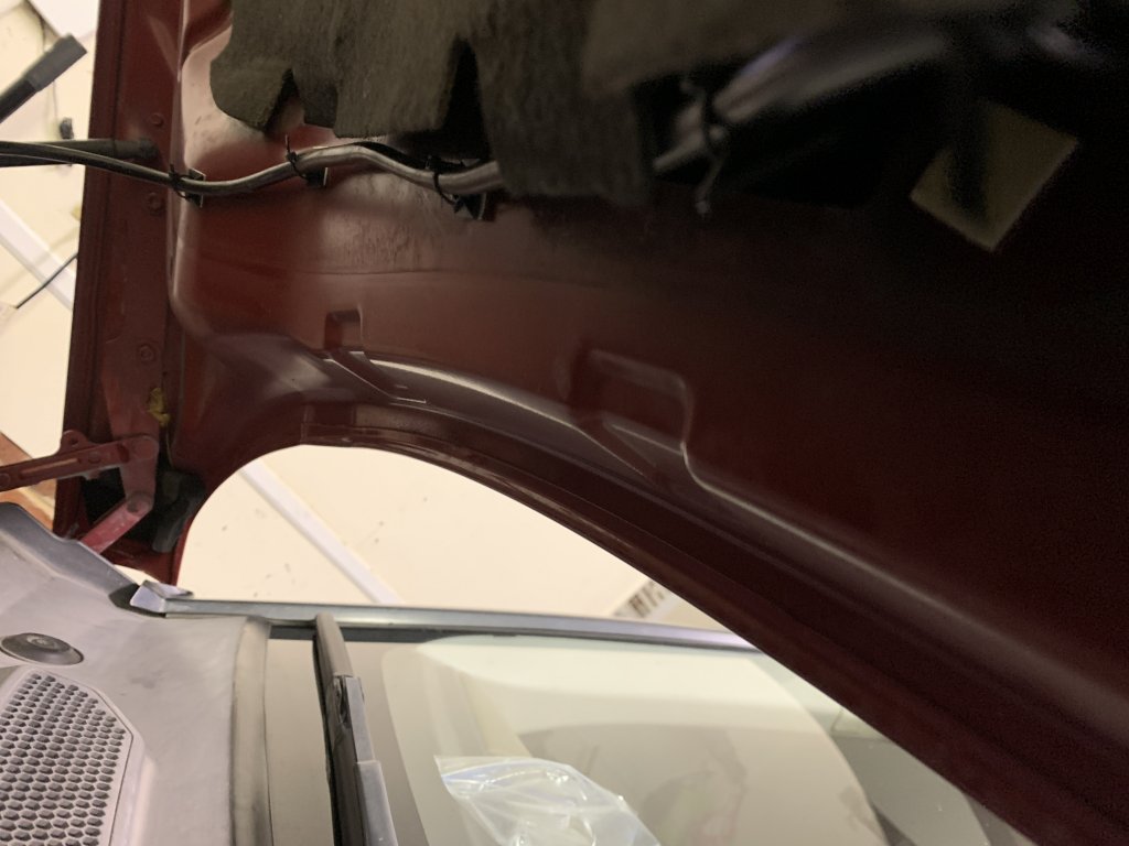

GREAT MOD! Pics on the underside too please - Promise no judging on your wire mgt
I took off the hood/bonnet gas struts long ago and just use the hinge locks. Love how much more it opens (Vertical now). Hope you have enough slack in the wire.

Will do! Sorry for the delay...was doing this
here are photos. It’s just a wire that comes down from the hood and connects to the box (which I affixed using double sided tape to the passenger side air intake cover). There is a positive and negative charging wire that connect to the battery terminals. The indicator lights on the box light up as soon as they connect to the battery terminals.
