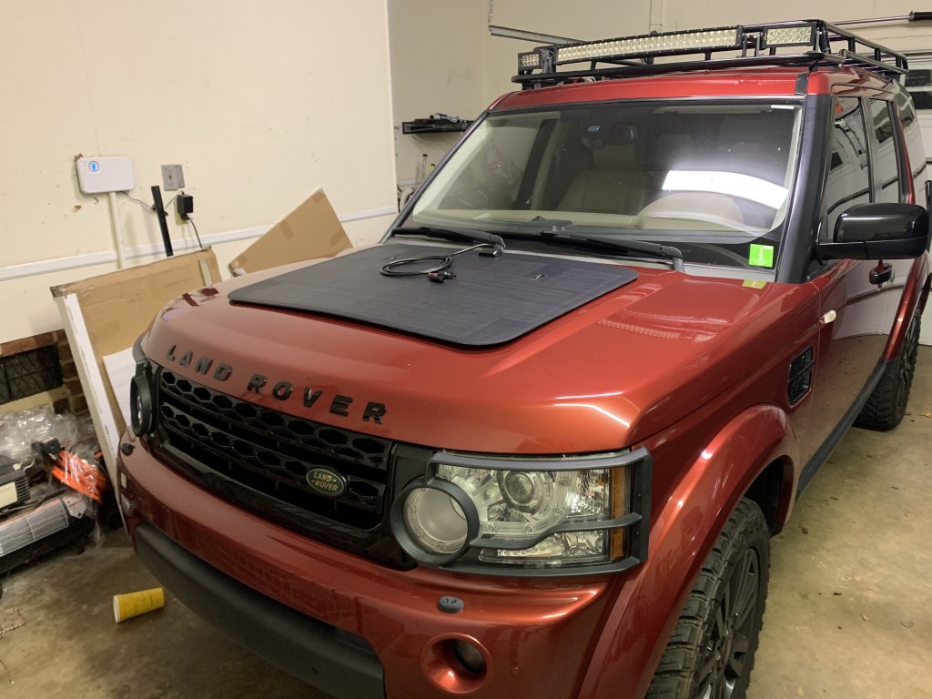

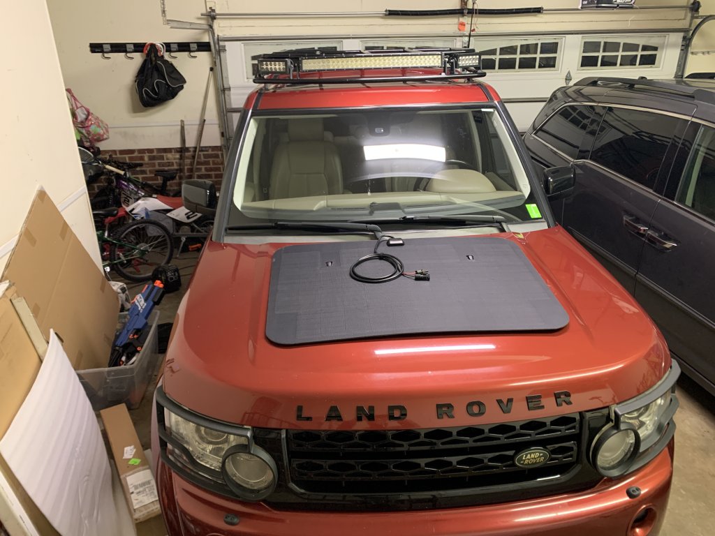

It’s arrived! Goes on tomorrow

Did you do the protective vinyl? How is it thickness wise?
I have a panel on my rack that pivots, but I may eventually add this just to add watts and I wanted a hood blackout anyway. Slick!

I did the vinyl that was provided. It’s not thin. The panel itself is about a 1/2 inch or more in thickness. It’s also heavy. My gas struts are having a hard time holding the extra weight of the panel which was not anticipated. It was not hard to do and the instructions are very good.
I thought about a panel on my rack, but I use the rack a good but and just didn’t want to lose real estate up there. This seemed to check all the boxes.

Looks good, Scott! Thank you for the feedback and some of the friction areas. How is the wiring routed? Looks like from the box on the back of the panel. Then, just run along the top of the hood to the hinge and down?

Yes, that’s exactly it. There’s one set of wires that runs to the charging block which regulates how much it charges. There are then two wires (positive and negative) that connect to the terminals.

GREAT MOD! Pics on the underside too please - Promise no judging on your wire mgt
I took off the hood/bonnet gas struts long ago and just use the hinge locks. Love how much more it opens (Vertical now). Hope you have enough slack in the wire.

So you apply the vinyl onto the hood and then tape the solar panel to that? I'm surprised by how thick the panel is, a 1/2 inch? I have an Overland Solar panel taped to my glass roof on my LR3 with 3M vhb tape and it's only about 3-4 mm thick total.
Problem with the roof mount is when I put my roof rack on it's not charging due to all the stuff I carry on my rack so I'm looking to add the hood mount to get power no matter what. I only put my rack on when I do a big adventures which is a couple times per year, and the solar really matters in the winter when I'm not driving as much.
I've contacted Lensunsolar about their panel (thanks for that @djkaosone), very similar to the Cascadia in size, but Lensunsolar was able to get more output due to the array layout and it's advertised as 2.5mm thick, also slightly lower cost.
