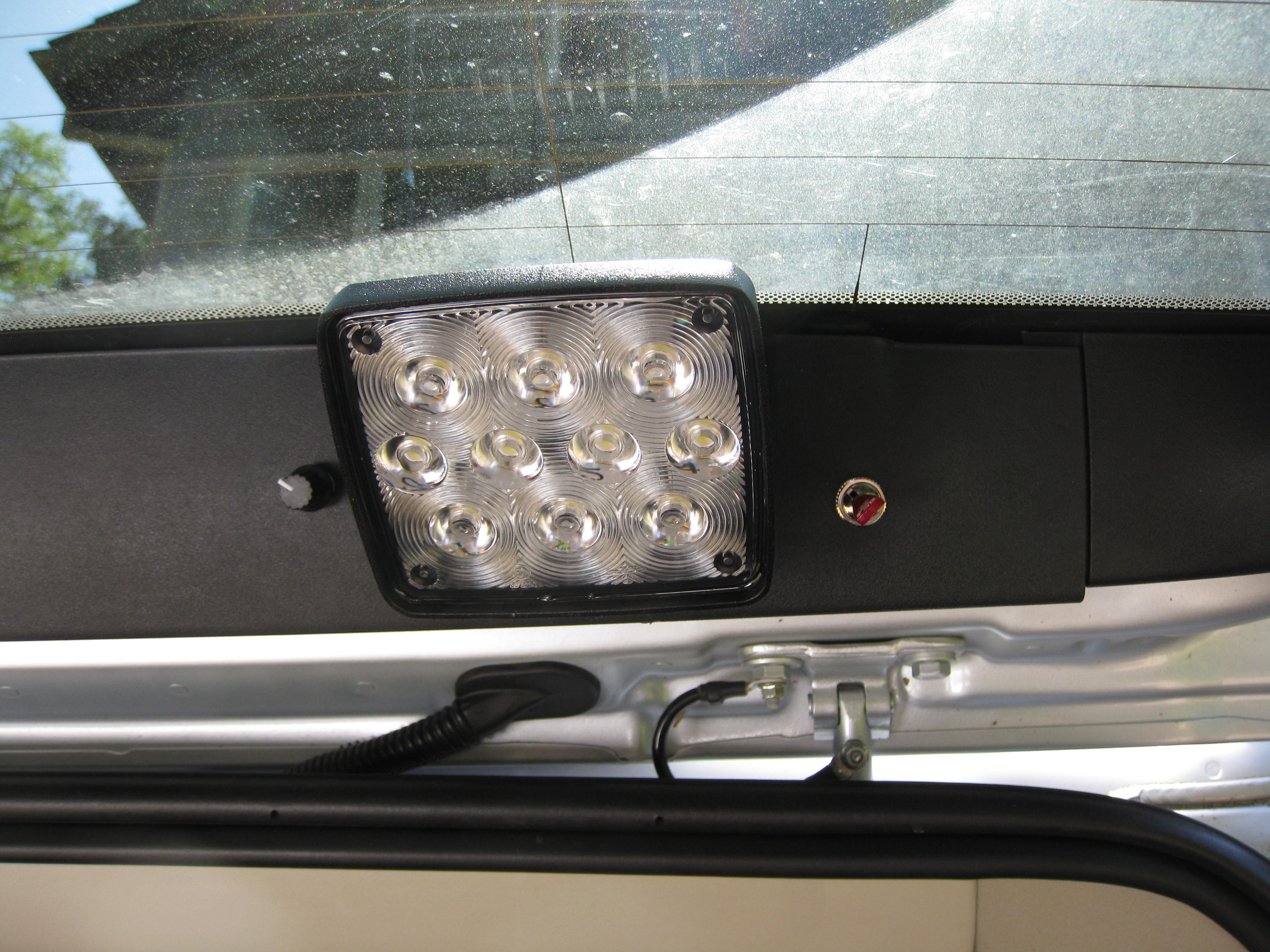

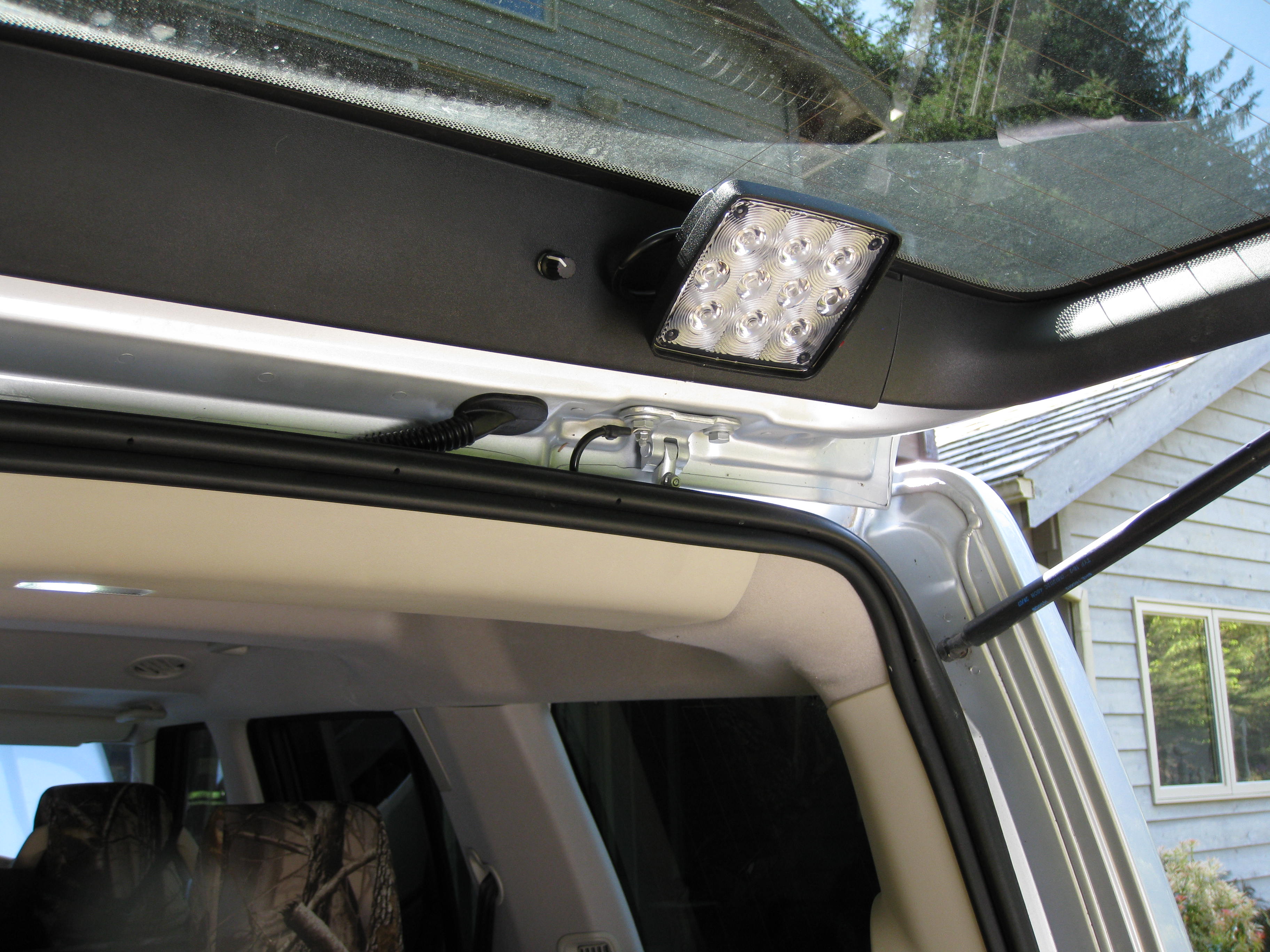

I wanted a rear utility flood light for working on the floor, lowered hatch, and night activities around the back of the truck. I looked for a location and settled on an attachment to the hatch top trim. This allows swivel pointing to the right and left as well as onto the loading deck and behind. I wanted a switch and a dimmer for the bright LED fixture.
I selected a flood light from the marine store.
The light is a Westbar Products #54209-002 Flood 10 watt for $67.00.
I added a toggle switch and a LED dimmer that I took out of it's housing. I ran the 18 ga. wires across the top trim and down the drivers side C pillar into the rear under floor area. I added a 30 amp Anderson connector to be plugged into a fuse block at that location.
