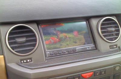

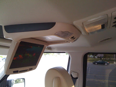

I have recently copied essentially this same setup. I installed it myself - I have trust issues. Let me know if you have any questions. BTW - I dont need my Audiocontrol overdrive anymore. It worked great to bring the AUX volume level up to equal with FM and CD. $50 Shipped.
MORE PICS
DVD Player and additional screen. In my setup - If the drop down screen is watching a DVD, the front touch screen can be watching DVD, GPS, Ipod, or reverse cam, etc. BUT if the drop down screen is watching the GSP, Ipod, or reverse camera the front screen must watch the same. This can be a small legal issue, and I havnt figured out how to fix. Hasnt been an problem since my 2YO has a book of DVDs I havnt needed iphone video. YNMV.
