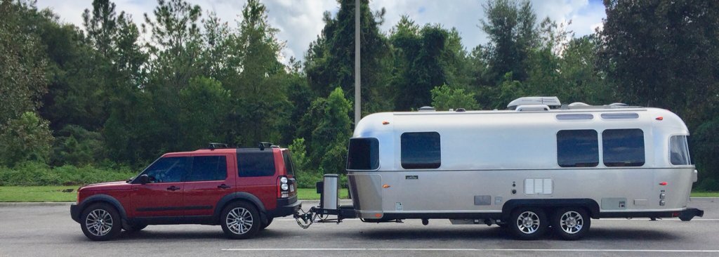

Hello
Pulling 25 Eddie Bauer and using Equalizer 10000 WD hitch
Agree struggle as I drove smoky mountains but other wise pulled great.
Actually looking to buy F150 3.5 EB w/max tow.
LR3 might be up for sale very soon. Have to give it up but plan heading west this early summer.
manoftaste
Sep 18, 2006
618
194
What a beeautiful sight :)
Really, LR4USN?! Ur gonna replace that pretty red thing (future Defender on its own) with a 150? :)
LR4USN
Feb 25, 2013
292
52
Yes, manoftaaste, thought of getting ‘16 RRS Td6, but still at 7716 tow rating.
With added tq 325 vs 440 should help a bit.
LR3 has been sold outside of regular maintenance items. She’s been well cared for!
