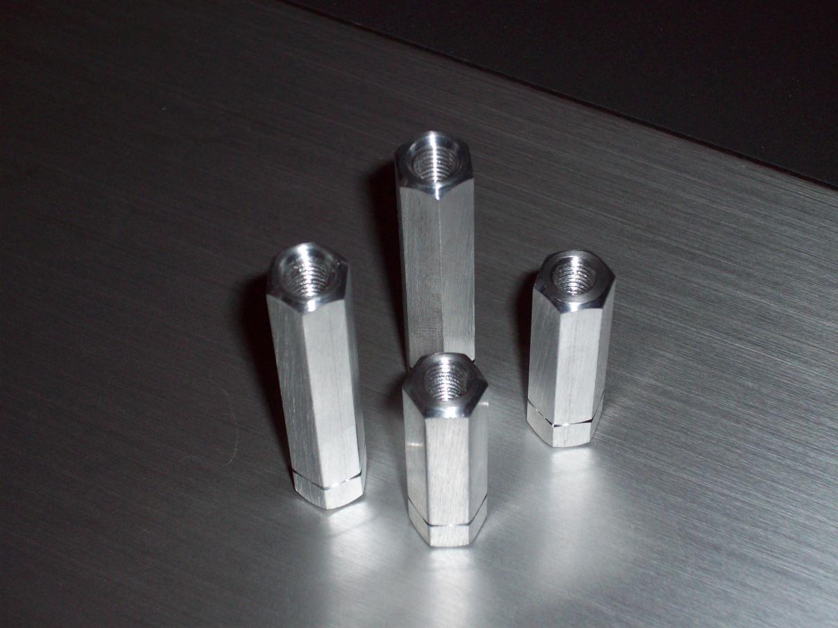

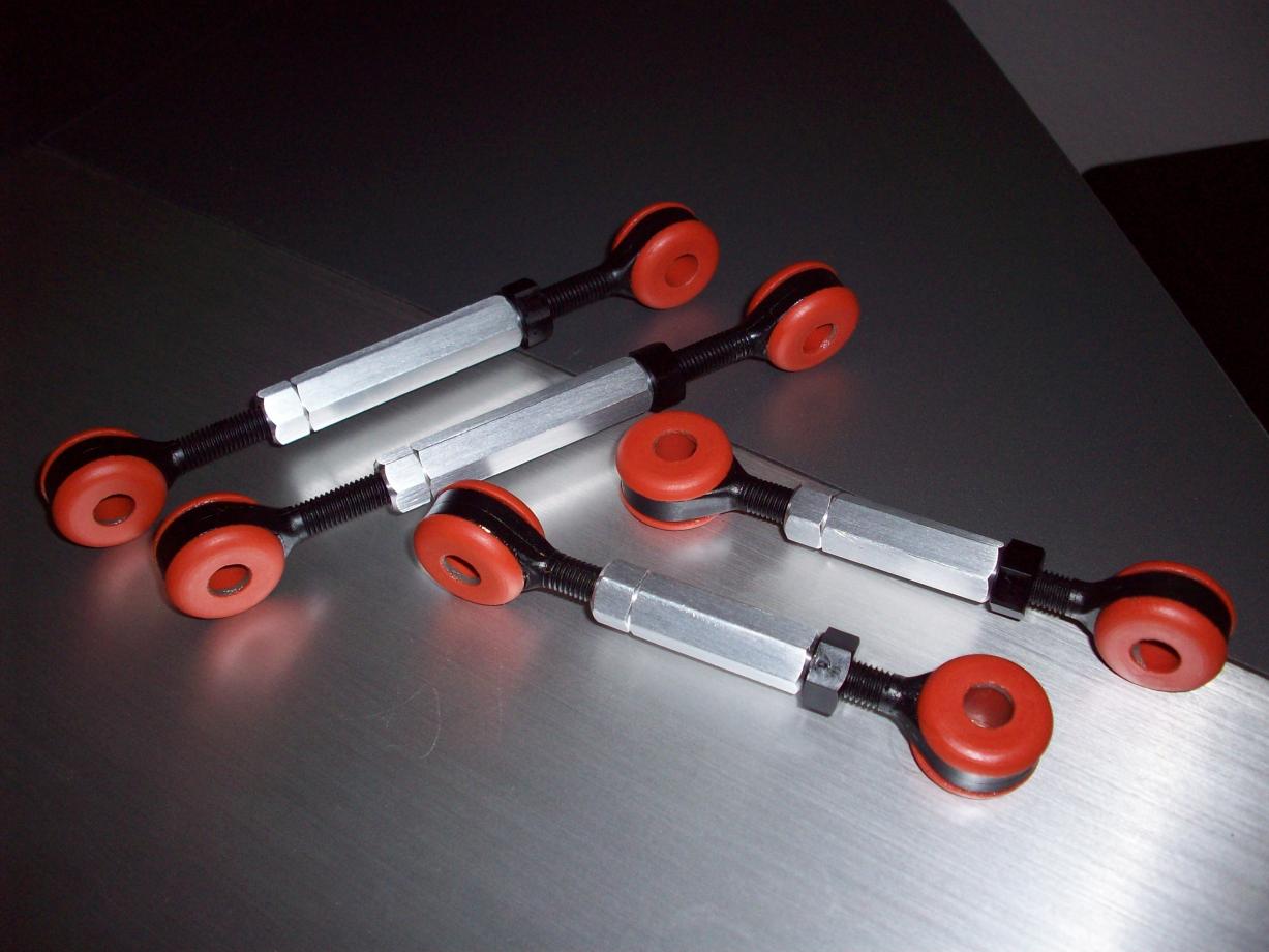

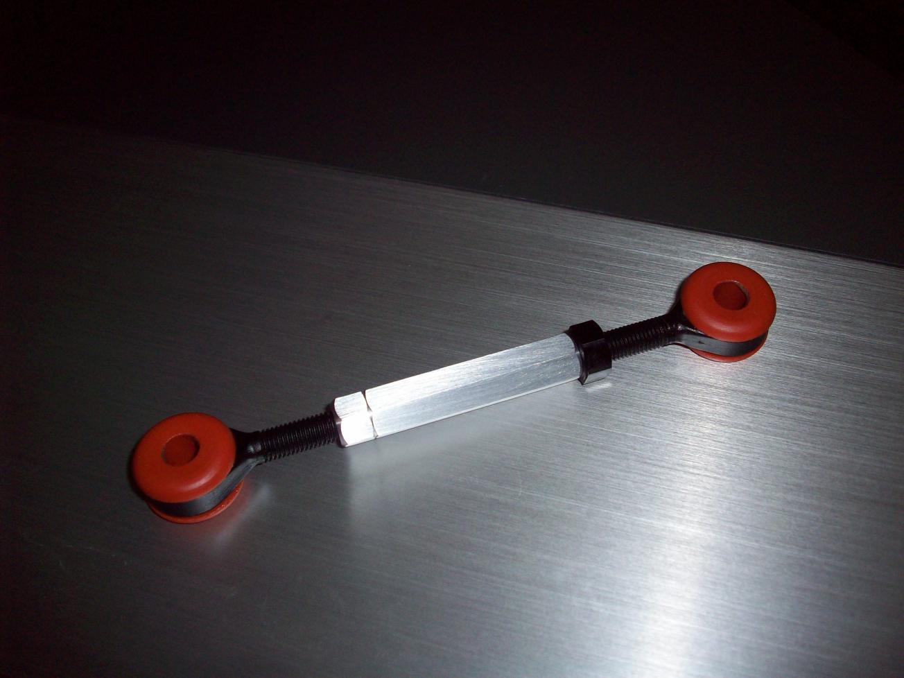

There are no indicators per se, as they are infinitely adjustable. The set is pre-adjusted prior to installing. I don't recommend adjusting while they are installed. It's much easier to remove them, adjust then re-install. This assures that each sensor will be sending similar values to the computers. The heim joints are left-hand and right hand thread. As you turn the connector, each end moves equally in or out. Pretty slick.
WOW! :biggrin:
That is amazing. Congratulations on an incredible design.
Do you have a range of lift variation? I mean how short/long can the rod be adjusted?

Thanks for the kind words! The total range is zero lift to 2-1/4". I highly recommend not exceeding 2-1/4". The set can physically go beyond that, but you lose the ability to properly adjust the camber setting while doing the alignment. What's also nice is you will have the ability to level out the stance from back to front. Some people like the "raked" look (rear sitting taller than the front). I prefer a more balanced profile. That's the benefit of having micro-adjustments built into the set. A fixed "lift kit" gives you one option only.
