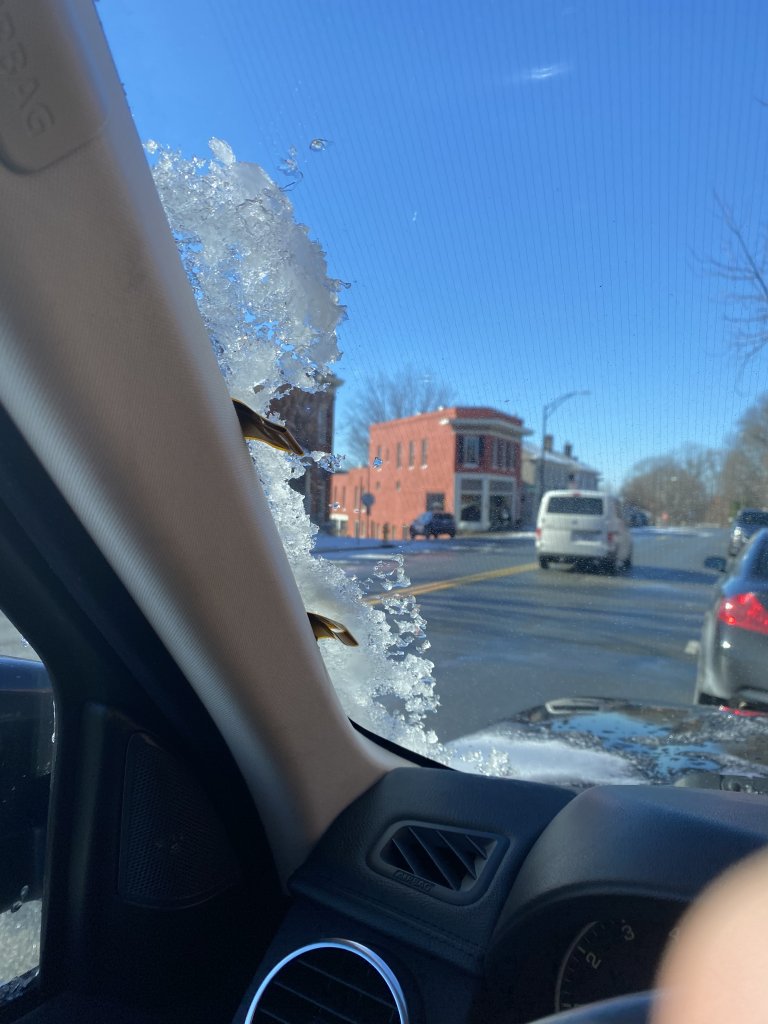

2. Posting some pictures, are these damaged items easy to fix? Also the brown tape on the left of the front windshield- is that for defrost?

-Brown tabs left of windshield (what’s going on here?)

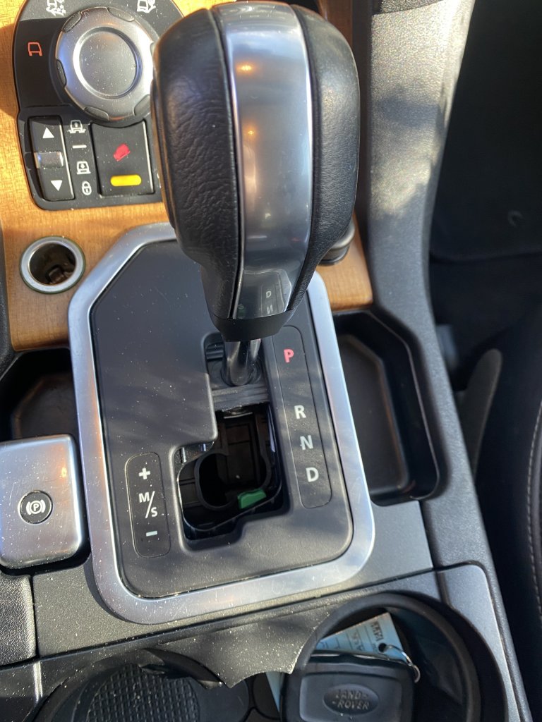

-Broken plastic on shifter area when in park (hard to repair? Junk yard parts?)

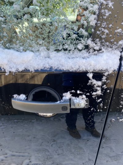

-Broken plastic cover key area on drivers door. (hard to repair? Junk yard parts?)

You can remove the A pillar by pulling off the "air bag" plastic plate to reveal t30 bolts to tuck in the brown tabs.
The shifter, unfortunately that's a "new" shifter. And whatever you do, do NOT get any liquid in there.
Third pic, someone posted a part number.
