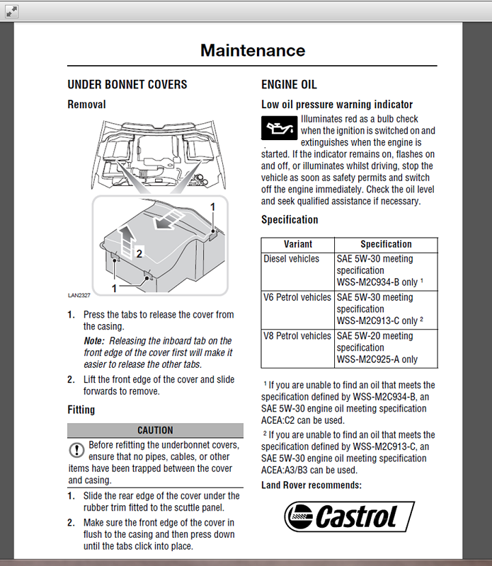

This is what I have in my shop manual for the engine oil:
SAE 5W-30 meeting specification WSS-M2C934-B only ¹
¹ If you are unable to find an oil that meets the
specification defined by WSS-M2C934-B, an
SAE 5W-30 engine oil meeting specification
ACEA:C2 can be used.
This is page 209 (of 7500):
