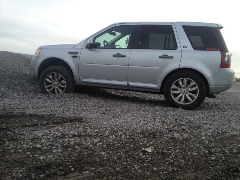

We have up sized the Lr2 tires. Just watch how wide you get.
That's nuts - I'm researching 255/55r19's for my wife LR2. Hers is the same color with the L8 sticker in the same location.
Looks like 255/55 ZEONs unless anyone has any last warnings.
