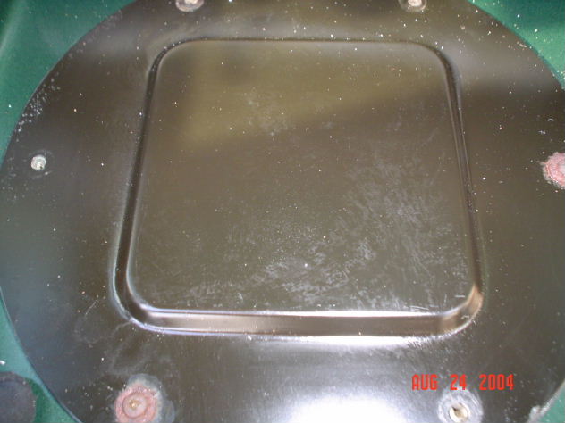

Ok ..Well The rover is still not starting. I have pulled the carpet up in the back put my ear to the floor and I hear nothing. Could the pump have gone bad already? If I trade the Rover in without it working/running they are only going to give me $$4000.00 for it.. I paid well over 15K for it two and half years ago. @ this point I do not think it is a sensor.. Now it just acts like something has gone out completely. Here is a pic of where I put my head and I hear nothing! Nothing @ all .. Why do I still have fuel coming out of the shrader valve if the pump is toast? TIA.

1) check fuse under hood
2) check innertia switch. I cant remember but to my recollection it has to be pushed if it did cut out once.
3) unhook electrical connection from pump and stick it into old one . Check if its even trying to go.
There are known rotting electrical issues for those pump connectors.. I seem to remember seeing detailed picture of those somewhere.
Or it can be just loose connection on pump when you changed it, so when its heating - its sliding out..
Dont turn back on henry yet. Now we know where to truck issue to..
