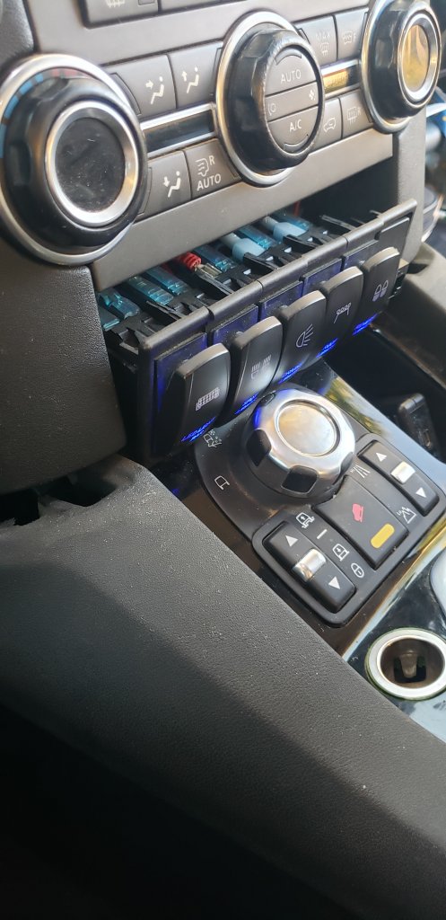

Switch panel right before it snaps into place.

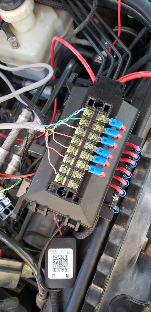

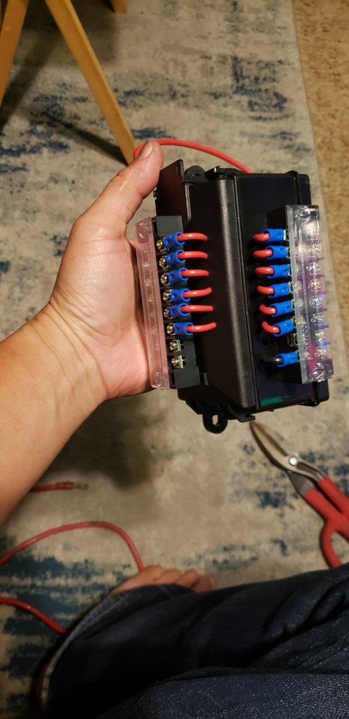

Fuse and relay box.

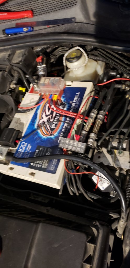

XS Power D3400 aux battery in the brake booster location with the fuse/relay box installed.
The cat6 signal wire from the rocker switch panel connected to the fuse/relay box.

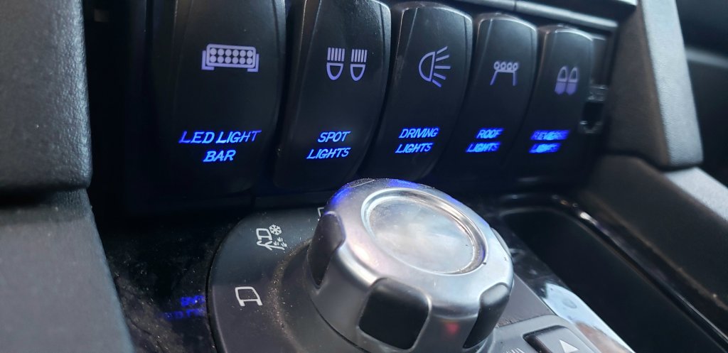

Rocker switch panel with a rj45 outlet for my ham radio mic input on the far right.

Woah very well done! Jedi-level wiring skills you have. So, obviously not your first rodeo. I’m thinking about some camp scene lights as well. If I end up with more than one switch, your method is the way to go. Dare I ask how much of the center section needs to be ripped apart to delete whatever the ashtray mechanism consists of? Cheers. Oh and sorry op for high jack.
djkaosone
'11 LR4 HSE LUX 5.0L V8
Oct 26, 2015
1,108
798
SoCal
You'll need to pop off the gear selector and radio plates to remove the ash tray. I got a universal 6 gang rocker panel and added switches. It's about a 95% near perfect fit, 5% was to trim off just a bit of the rocker switch panel to fit properly.
