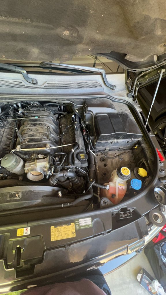

New ground set up, car still starts up, voltage is still high and battery is now charging. I might just leave it like this if no one else finds the issue with what makes the resistance high on the regular configuration.
Only thing is one of my MAF Senser’s reads -30 volts which I don’t understand because it works just fine. Gas mileage is good and the car runs fine. Might just leave it unless I start getting a CEL or the car acts up.
