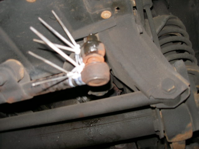

Mine has been doing it at low speeds and today has just come apart! Luckily I was at a stop sign making a turn and it broke half way through, so I was pretty much stuck in the middle of the intersection. Now is this something that is hard to fix? The part that has separated controls the rod that moves the tires. It looks like the rubber ****** has broken off and there is no lube only dust in the joint. Is it just a case of replacing the rubber ****** or……….

Here is a pic of the broken ******...

So do i just need a CV Boot Kit, are there any instructions on how to replace this?

What you have is a broken ball joint.... I would look at replacing them all while you are in there.

So should i replace the whole rod... any instructions? How do i get the broken bolt out?

No need to replace the whole rod that I am aware of.... I will look for instructions, broken bolt... pain.
