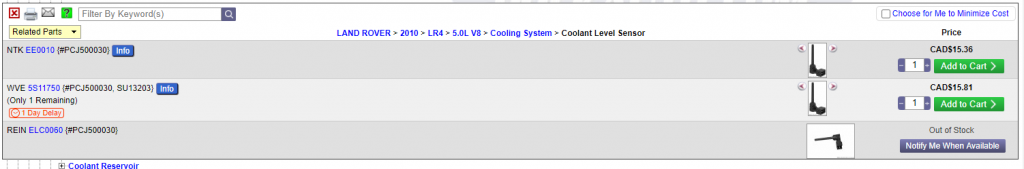

Sensor goes bad. About $5 from Rock Auto. Sorry inflation they are $15 Cdn now...
1,403
Sensor goes wonky. Easy to replace at bottom of reservoir.
