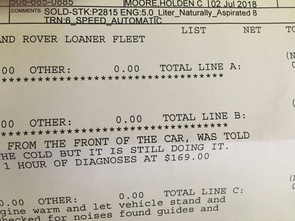

Anyone know what this means in the comments section? Is the “Sold-Stk” short for something?

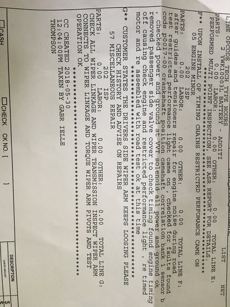

Also, here is what was done to the vehicle as well as the error code. Not sure if all of this is typical for this type of repair.

I searched that string and found it on a few other auto repair invoices but nothing seemed especially suspicious about it. Have you asked them point blank if they have replaced the engine?

Not yet. I am going to wait a day to hear back from Land Rover regarding my claim.
