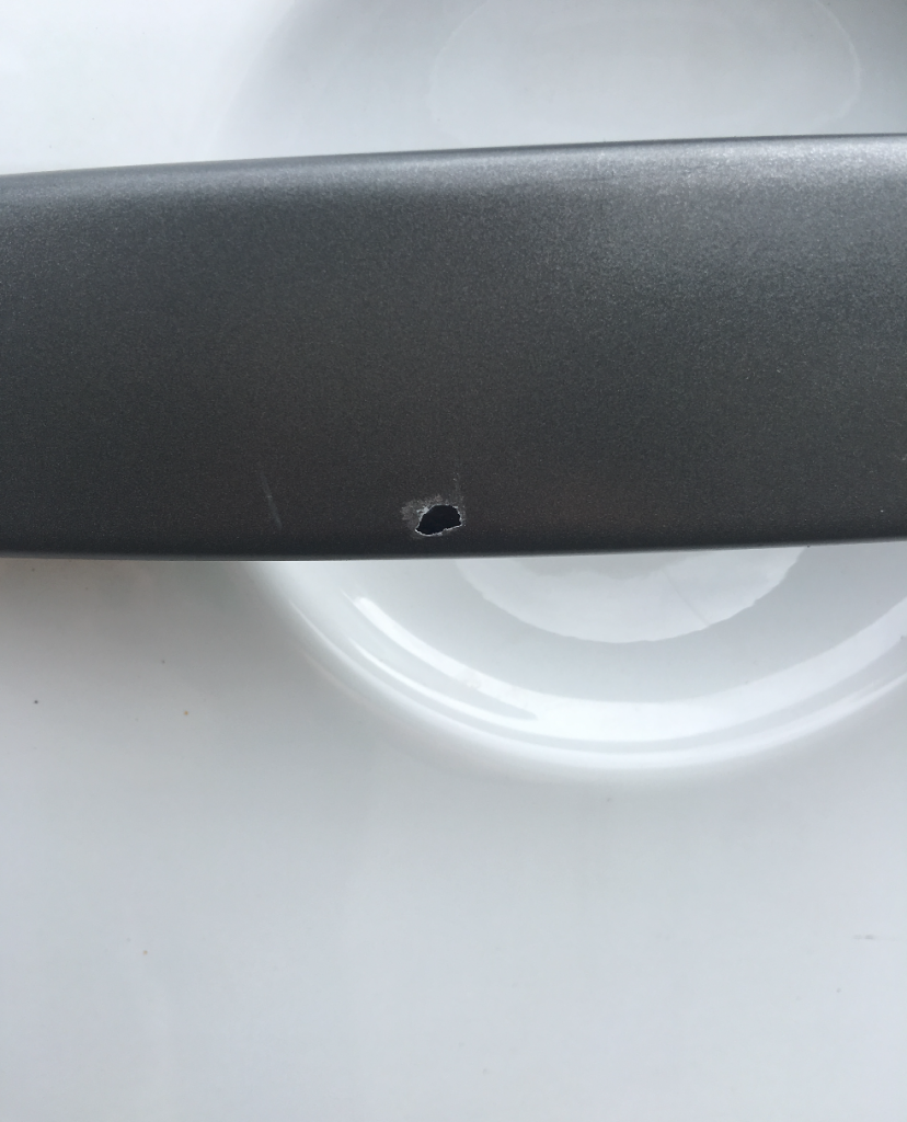

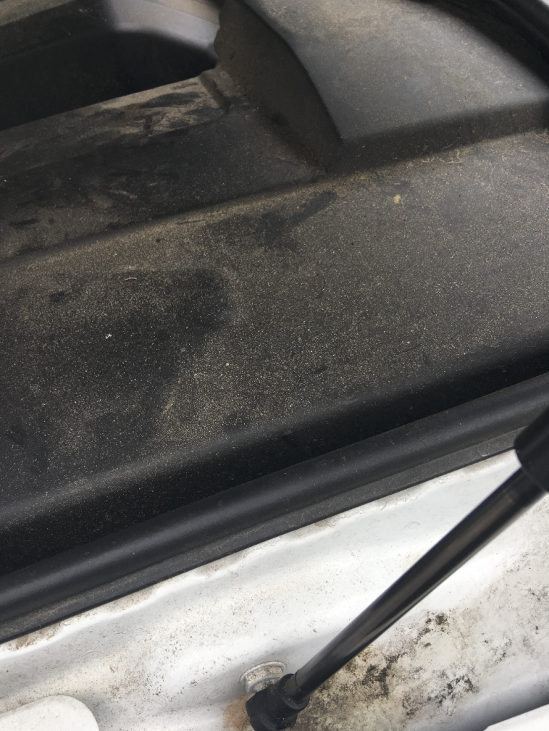

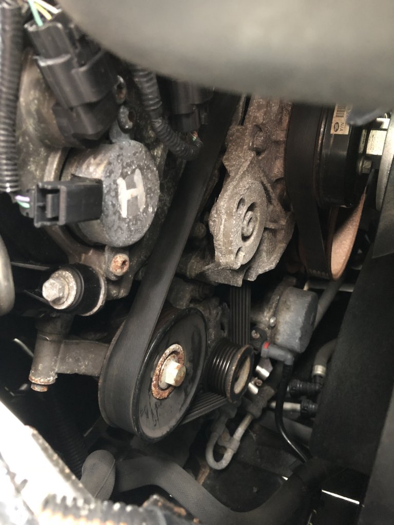

    They finally brought the vehicle to me a few days ago. Upon receipt, there was a scratch on the driver side door, and the handle had a nick in it. There were cobwebs all over the vehicle. Even more alarming, though, was that the pollen from the spring was still all over the engine and engine cover. It looked like it hadn't even been touched. Many of the bolts were corroded, and it looks like none had been removed. Also, there is an "H" marked on the engine, which I can't recall ever being there, but I'm not 100% sure about this. My husband seems to think that this is "junk yard" markings. While the ticking seems to have been fixed, the actual shifter is incredibly stiff and clunky, not the smooth shifting that it had before going in.

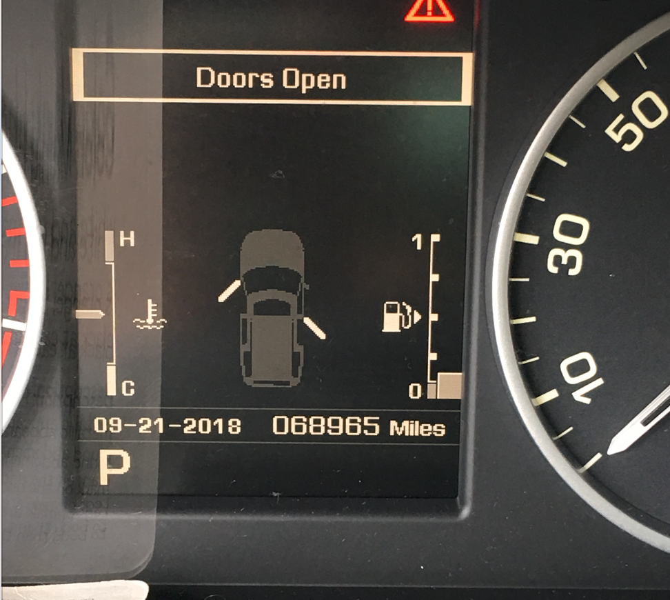

    Also, not sure why the oil change mileage is 77k, when the vehicle has 68k. They changed the oil as part of the service, but did they drive it over 1500 miles?

    Hmm... lots of corrosion on the motor. Where do you live? I am in Maine, and my 107K motor doesn't look that bad.
    The only way to prove the engine is not the original, is to get LR to provide the original build sheet, that has the serial numbers of all of the components put in the LR4 at the time of the build. Not impossible, but most dealers will not provide it.
    The diry and pollen is as expected from a vehicle that sat all summer. It would have been nice of the dealer to clean, but not compulsory.
    Try to get the original build sheet, if you truly think the motor was not the original. None of the bolts look to have been removed, which is very suspicious in itself.

    Thanks! We are in MA. Supposedly, the repairs were done mid-August. The fingerprints seen in the above photo were from us. I have "before" photos, too. I wish I had a "before" of the motor, but I didn't think to take one.

    I agree with your husband about the junkyard markings, and that engine definitely looks like it has been sitting outside of a vehicle for quite some time. Sounds like an awesome dealer.

    I agree with jaguardoc504, have the dealer provide the build sheet. Then you can check the engine serial number to determine if you have the original engine or a replacement. If a replacement, I would want to know where it came from and how many miles on it. If from a junkyard, that seems shady as usually dealers will only install OEM parts, even if it's an engine. If they sourced a rebuilt engine it would certainly look new on the outside and come with a warranty. I would contact Land Rover corporate in NJ and get them involved immediately to document your story in writing.

    I would not be very confident either until I get the truth about the engine. Replacing the timing chain and chain guides is a very common issue on the 2012 LR4. It could take a couple of days as you have to pull off the front bumper to get at it, but not months. Maybe the tech installed it wrong and damaged the engine at start-up. Then you deserve a new or rebuilt LR engine, not a mystery junkyard engine.
