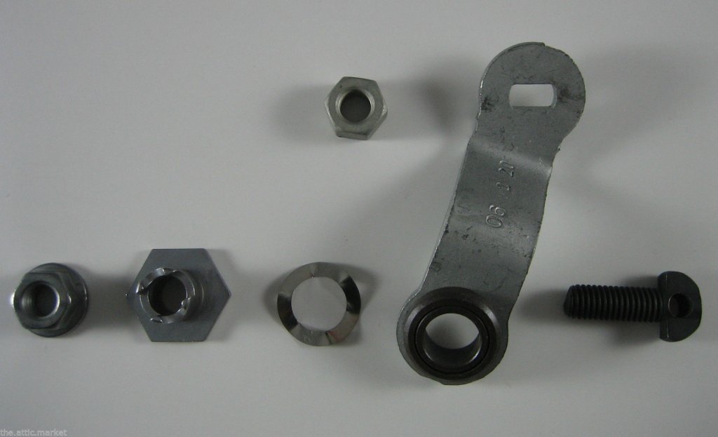

The jpg is the gear shift lever kit - the bits rust, (see doc), and get hard to move. Fortunately, it is a do it yourself change out but not easy if all rusted. The part number is LR012704.
