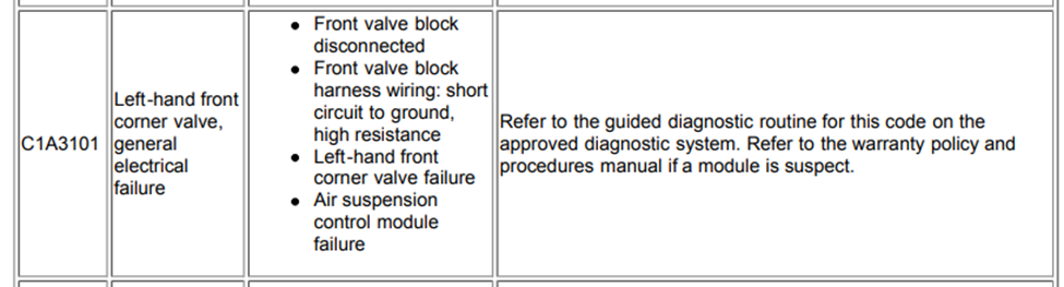

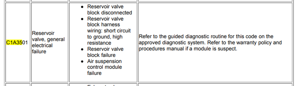

When starting the car, I instantly get a suspension fault when the compressor kicks on. I have scanned the codes, and I get c1a35 - Reservoir valve, and then shortly after, if I clear it and try and raise the car, I get C1A31 (front left corner valve). Upon these issues, I have put a new compressor, dryer, front valve block, and reservoir valve block in, and these codes and issues are still present. The weird thing about it all is that the front never really lifts, but the rear would lift and go into off-road height despite the fault. It wasn't until recently that the front lifted up a little bit.

It's all pointing to a wiring issue, perhaps check the wires all look OK. I measured the resistance on my exhaust valve solenoid and got 15ohms. I have a spare reservoir block and could measure the resistance on that valve for you to compare.
