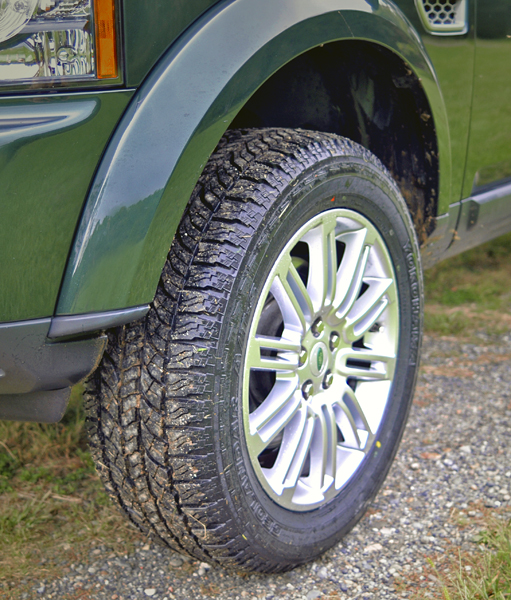

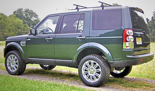

A while back I was looking for input on tire options for the OEM 20 inch rims. Not a whole lot of feedback. I have johnson rods on the vehicle so I figured I would ask Greg Johnson. He has a list of available tires for 18,19 & 20 inch rims for the LR3. I decided to go with the Yokohama Geolander A/T-S AT 275/55/R20 31.9 $155. He said that they "should" fit, but he couldn't guarantee it because the tire options on his website are for the LR3 and the LR4 has a slight variation in the frame which may cause some tire rub. I'm happy to report that with the johnson rods, there is no tire rub. Not a lot of clearance, maybe 3/4 of an inch, but the fit. Here are some pics.
