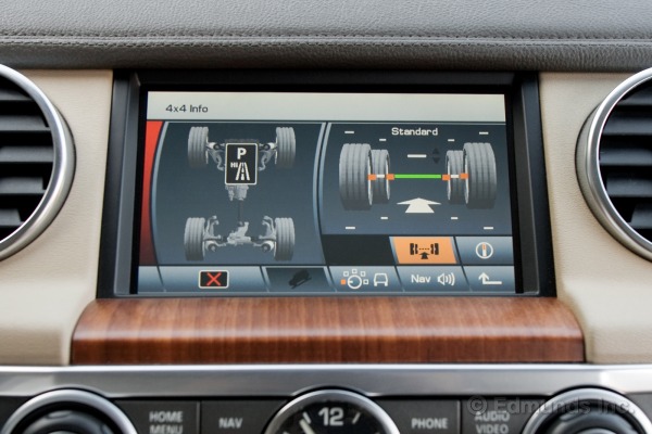

I'm new to Land Rovers and recently bought a used 2010 LR4. I can't find anywhere what the little lines under each wheel mean on the 4x4 info screen. The sales person drove the vehicle over the Land Rover off road course at the dealership, and I noticed one of the lines turned red at one point. The sales person did not know what that was. Thanks for the help.

They indicate the suspension travel limits.

AxelR is correct.
They indicate if your suspension and wheel is at the limit of its travel. Aka has no flex remaining.
Other than cross axle situations, w/o the rear locker HD option, where they indicate you will be relying on traction control & thus have to change your style of throttle application. I have not found a real life application for most people.
I'm sure there are some other applications, but I have not yet dealt with them. Maybe related to high center rampbreakover situations and extended height mode. I.e.(Should you continue forward or reverse out).
