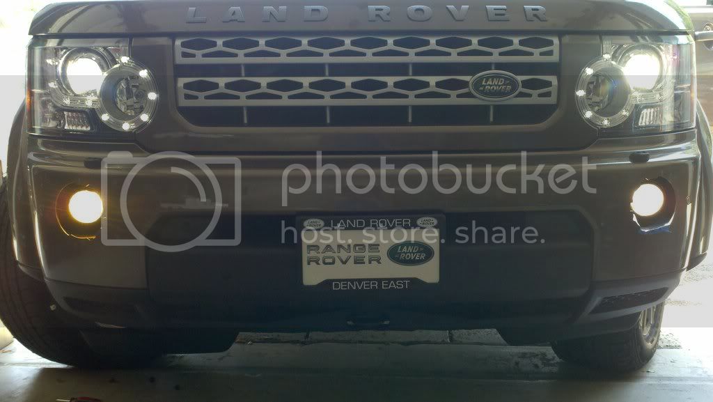

Ok ... Here's the final product (phone camera):
Mid installation daytime pics, PIAA yellow on one side and factory fog on the other:

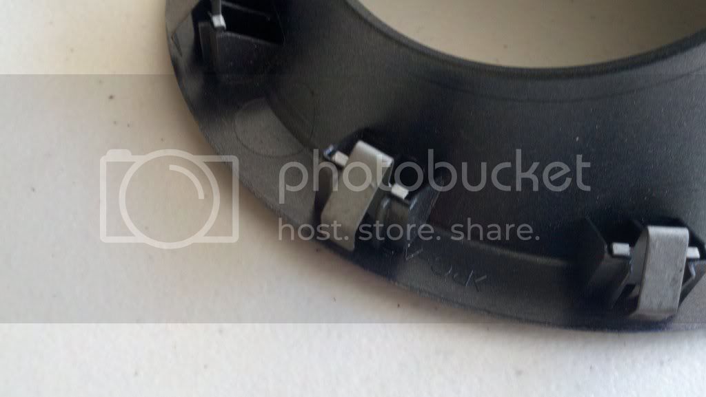

The trim ring around the foglamp needs to be removed by grabbing its inner edge and pulling straight out. There are a series of spring clips on the back that keep the trim ring in place:

I am definitely interested in the yellow as well, and now that I see the pictures above (AWESOME) it would look really nice on my Nara Bronze. The Oakland Zoo is a lot nicer than the SF Zoo, but it's still fun. Yes, definitely, we should have a gathering of SF Bay area LR4 owners... that would be cool!

WOW! This looks awesome!!! I have the same color (Nara Bronze) as you, so I am really happy to see the finished results. Do you have the stock HID lights or are those the Philips CV bulbs? Thanks so much for posting those pics, looks awesome! :)
