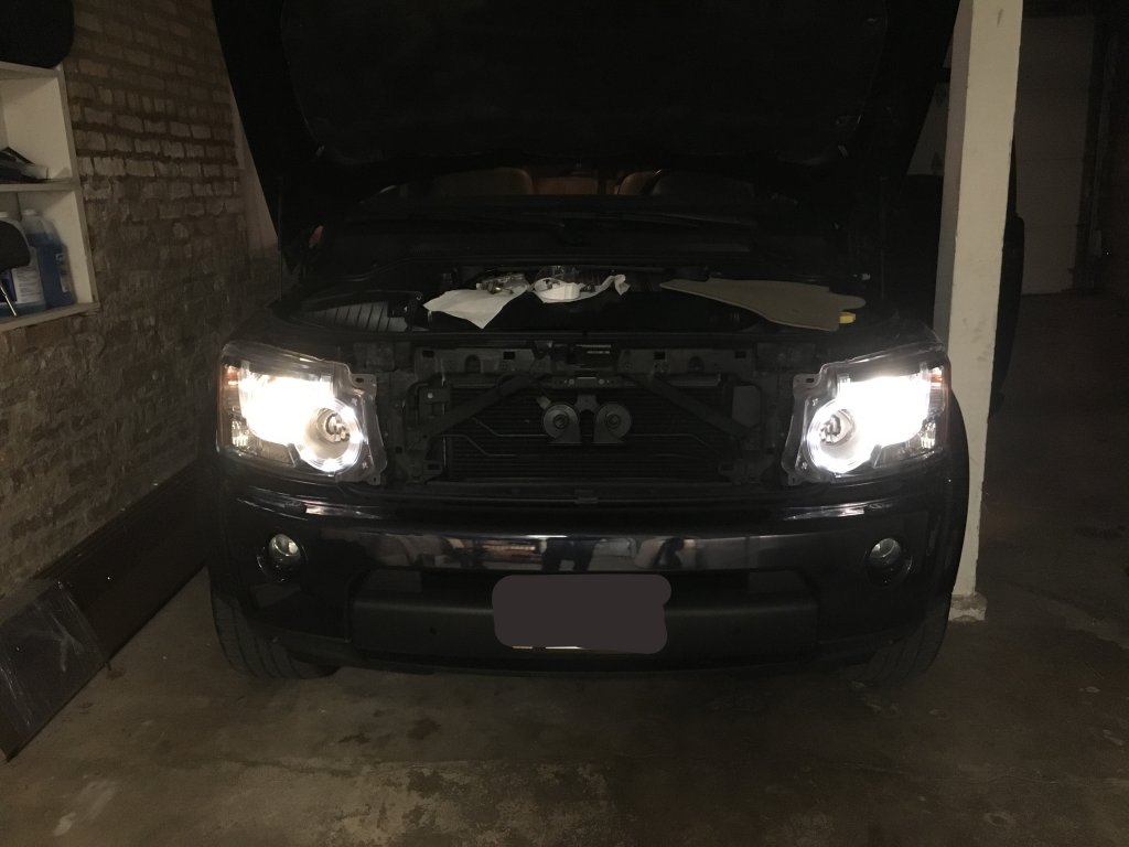

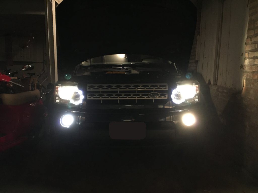

I just replaced my headlights and fog lights. I used Philips Crystal Vision Ultra for the headlights, which are much whiter than the factory halogens and look more like xenons while not looking too blue. I tried the Philips Diamond Vision for the fogs, but they look a bit too blue (they do however match the small factory LED lights nicely.) I might switch to either LED or Crystal Vision Ultra for the fog lights as well, or keep the Diamond Vision since they look nice when using just the small LED's and fogs together with no headlights.
First photo is new headlight on the right.
Second photo is the new fog light on the left
