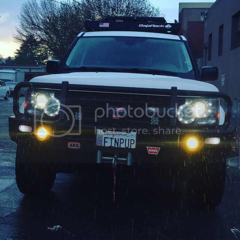

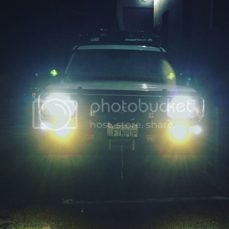

This may be slightly off topic with the current discussion, but I just installed some DDM Tuning 35W 3000k HID lights where I had LED fogs. I have to say I went back and forth with the yellow HID lights, but I am amazed at the visibility! Very impressive, it's such a difference. I have stock HID headlights and LED driving lights in my ARB and now these yellow fogs. I don't always like the yellow fog lights, but I think they look great in my ARB. Here are a few photos:
