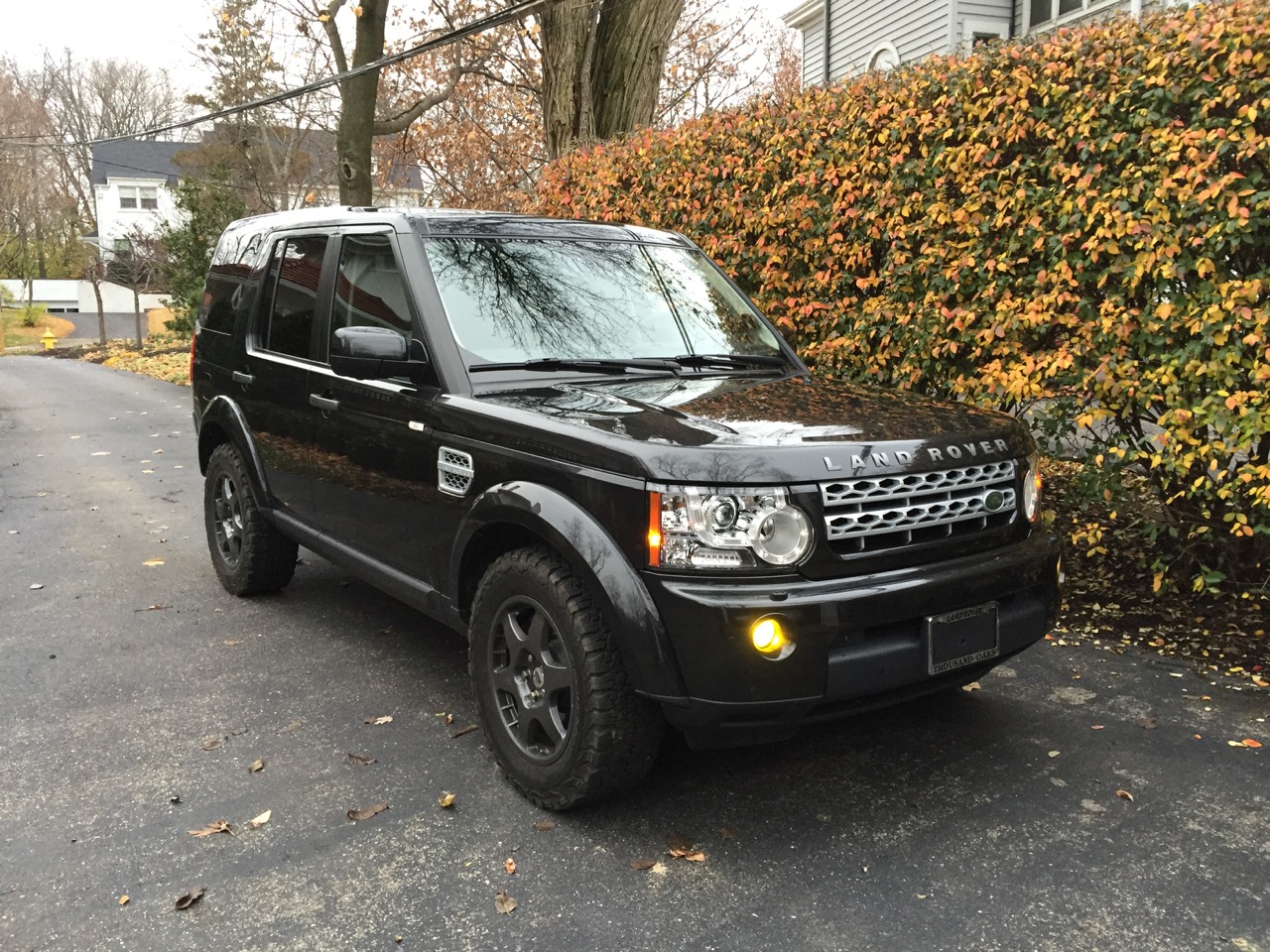

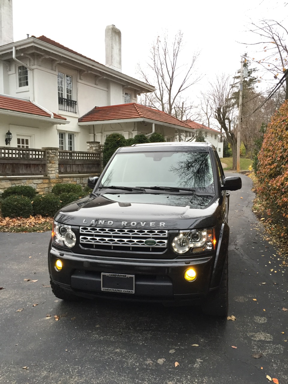

Well I installed the yellow Philips LED H11's fog lights over the weekend with no issues at all. They plug right in and I didn't get any error messages. I don't have a light meter, but they're really bright, with a very similar throw compared to the original halogen H11's. Recommended.
Here are some photos to give you an idea of what they look like installed. The color temperature contrasts with the xenons so much that its obvious you're not trying to match them–it looks good IMO. They catch peoples attention more so than whiter bulbs when using them as DRLs, and they work better as fog lights when you're driving in precipitation. Win/win.
This looks great! I am thinking of switching over to the yellow, more for function. I also just ordered a DDM HID kit for my fogs, but may go the yellow route instead.
