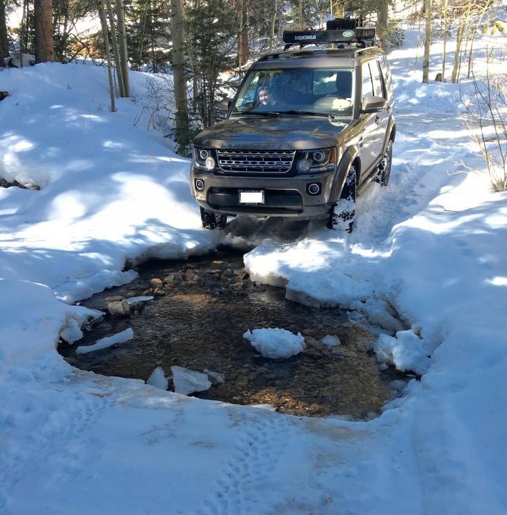

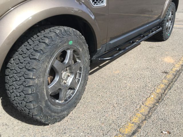

Seconding the 265/60R18 BFG KO2s. I've had mine since early March when I put them on for a trip to Moab and Sedona. They are working out great. Even used them to cross a snow creek with ice banks soon after I put them on.
