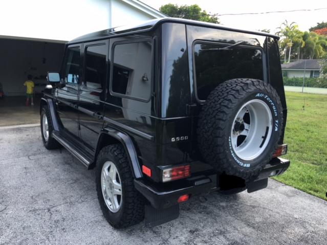

That grey LR4 looks very cool with both the LR3 rims and BFG tires..! Also just added a set of BFG TA KO2 to my G500.. see below..
If anyone is interested, I have a set of four (4) 18" LR3 block-style, 10 spoke rims in absolute mint condition for sale. They are like new and include the TPMS. If interested, rate is $150 each plus shipping from S.FL. Send me a PM and Ill get a ship quote for you. I have a post in the sale section... In the past, I've sold a few sets to LR4 owners and only step is to include spacers, dont quote me but I think its 30mm. You'll want to confirm that yourself..
Cheers!
