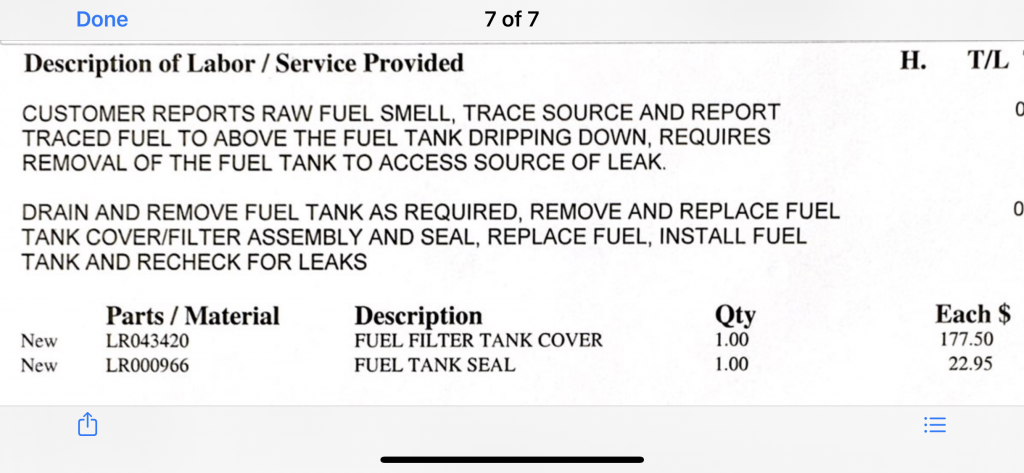

I kept smelling fuel when getting out after driving and decided to take it in, the shop told me this was a common issue (3 years ago or so). This is what they did:
