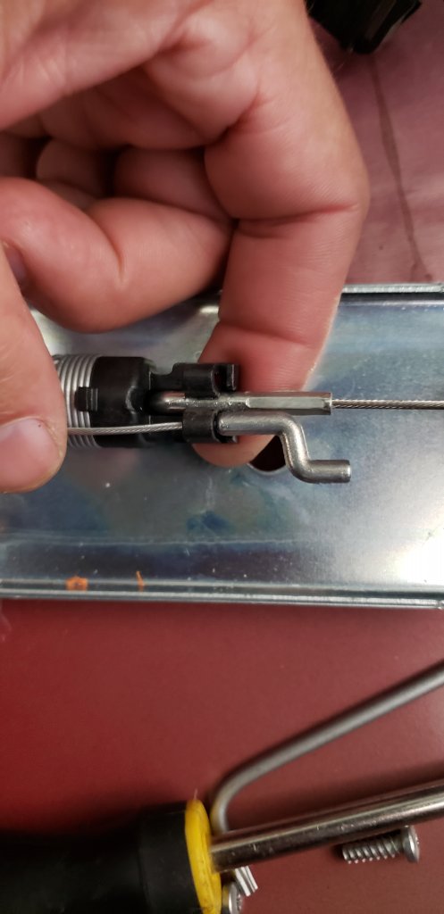

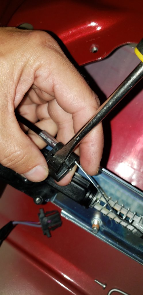

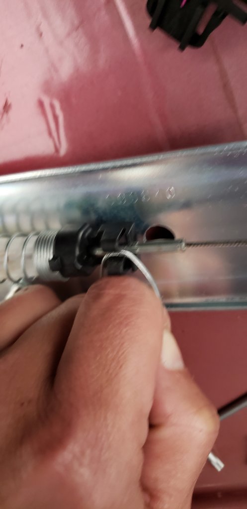

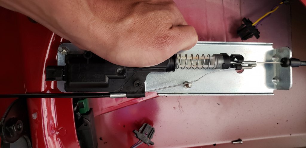

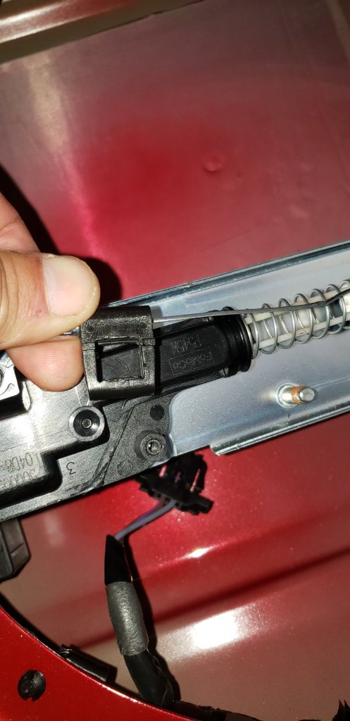

Gang,
I am going after the inside latch addition, and wanted to shoot some pictures up for posterity.. I found a different way to hook up the new cable- which requires almost no fabrication:
Push the new cable into the connector with the existing cable with a screwdriver:
Then pop the internal tabs out of the new cable bracket with a screwdriver, and mount the bracket below the actuator unit using the stock hardware. The assembly holds the new cable in place, and properly tensioned:
Easy peasy.
