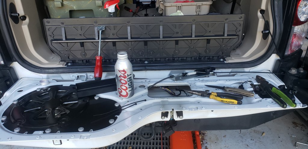

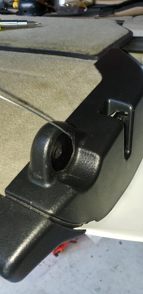

I ordered that recliner handle and originally planned to duplicate that install, but about half way through the process, I began to question the wisdom of cutting up parts that would be hard to replace. So, I came up with a workable, if not quite as elegant solution that didn't require cutting up the subwoofer cover plate or the tailgate trim assembly..

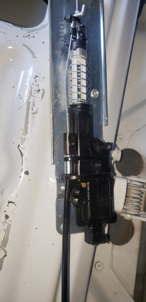

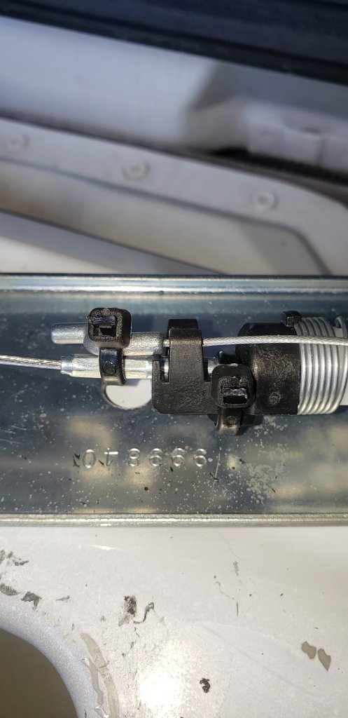

Like @Pfunk951 I hit on the idea of using the existing mounting bracket to secure the new "emergency" cable end. I then zip-tied the cable to the actuator assembly, as well as placing a zip-tie around the factory cable to prevent it from coming loose from it's mounting in the actuator assembly.

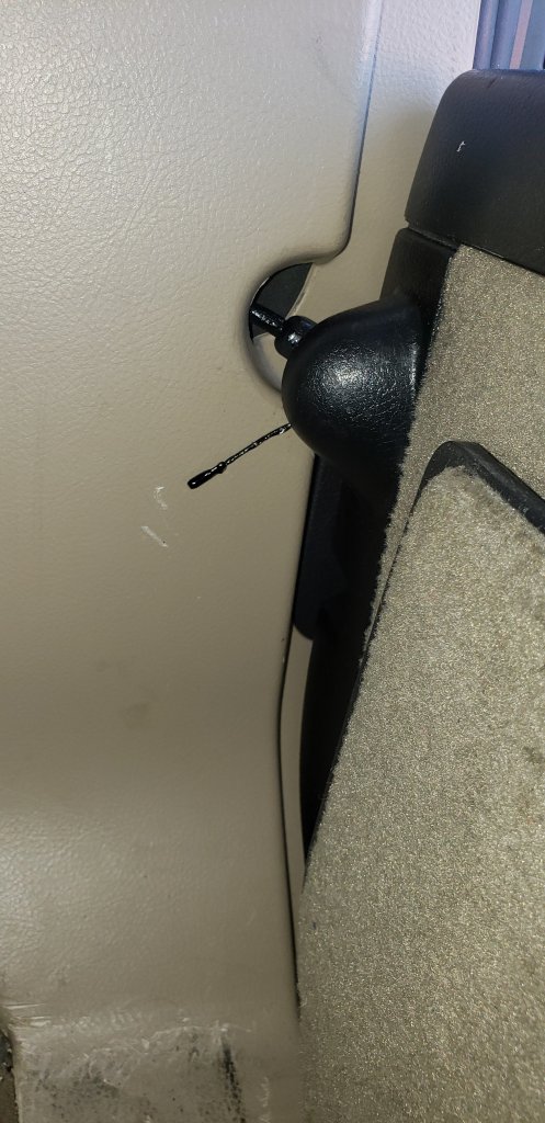

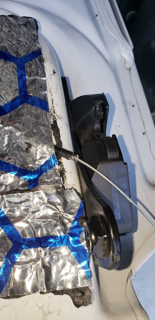

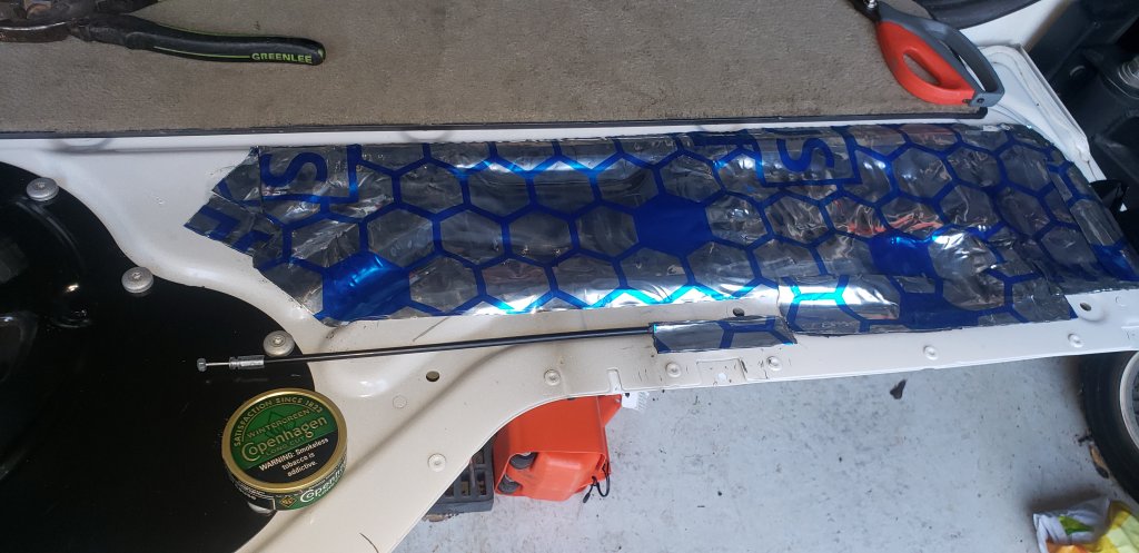

From there, I routed the emergency towards the right rear and used a Dremel to cut the cable housing (but not the cable itself) at the point where the cable protrudes from the opening that would have been covered by the factory vapor barrier. The cable is then routed through the opening in the tailgate trim where the factory support cables attach to the tailgate. I finished the cable off with a bit of black Krylon and a black bicycle brake cable end cap and Voila...a functional emergency release that is relatively invisible without the necessity of chopping up any of the factory parts.
I tried several different routings for the emergency cable, but most of them ended up putting enough resistance on the cable that the friction on the cable would overcome the spring pressure of the actuator assembly. What this means is that you could pull the cable to open the hatch, but then you would have to remove some trim to relieve enough friction for the spring in the actuator to return to it's normal state. The routing I used avoids this, and has worked 100% so far in my testing.
This last pic shows the cable routing that was giving me trouble. The curve in the cable, coupled with the friction on the cable from the tailgate trim cap was preventing the actuator from returning to it's normal position. The final routing to the support cable opening provided a straight shot from the actuator assembly, and avoids any pressure on the cable from the tailgate trim cap.
I might or might not tie a little lanyard to the cable to finish it off. Haven't decided yet.
FYI. My wife now thinks I am a complete goob for laying in the back of the Rover with a Coors lights and grinning like an idiot as I repeatedly opened and closed the hatch with my my new cable...

A couple more pics.
2 zip-ties and that cable isn't going anywhere. The emergency cable also routes out of the actuator cover without any cutting necessary.

@avslash , I'm not quite seeing the finished product here. How is the other end of the cable terminated, and how do you access it to trip the actuator?
