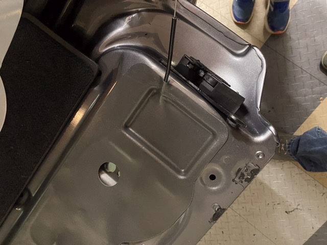

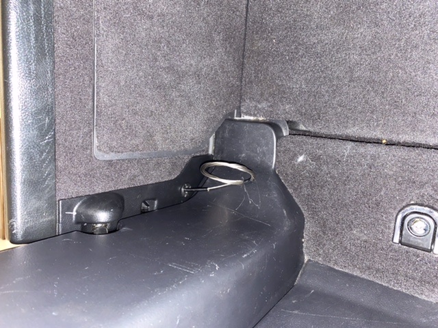

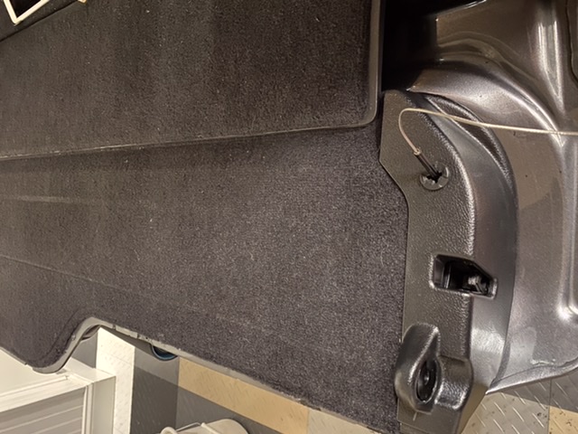

My tailgate failed on me and so went thru the steps to install new parts today. I used the procedures outlined previously but when it came to installing a manual latch I used a simpler method. I bought $15 in bicycle brake cable and cable housing from my local bike shop. Routed about 15” of both to the corner. Drilled a hole in the tailgate cover and used a grommet to get the cable to the right place. Need to get a cable crimp to make a smaller loop. But it works great! See attached photos for important cable routing points.

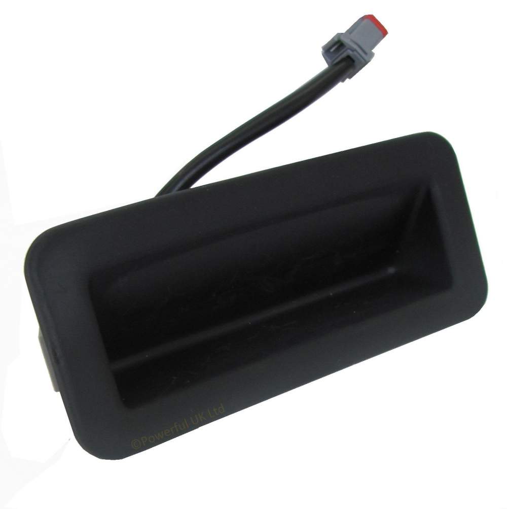

Got the new switch today. Ordered the one I linked above. There isn't a matching connector inside the rear liftgate so you are required to cut and splice.
And after all that, it does not work.
No idea what's going on. It's the correct, official Land Rover switch.

This is the new switch:
And the old one looks more like the Amazon link I posted last night--the only difference being the wiring harness. Regardless, the stamp marks on the back of the new switch are the exact same as the switch I took out, so I'm pretty confident it's the exact same.
