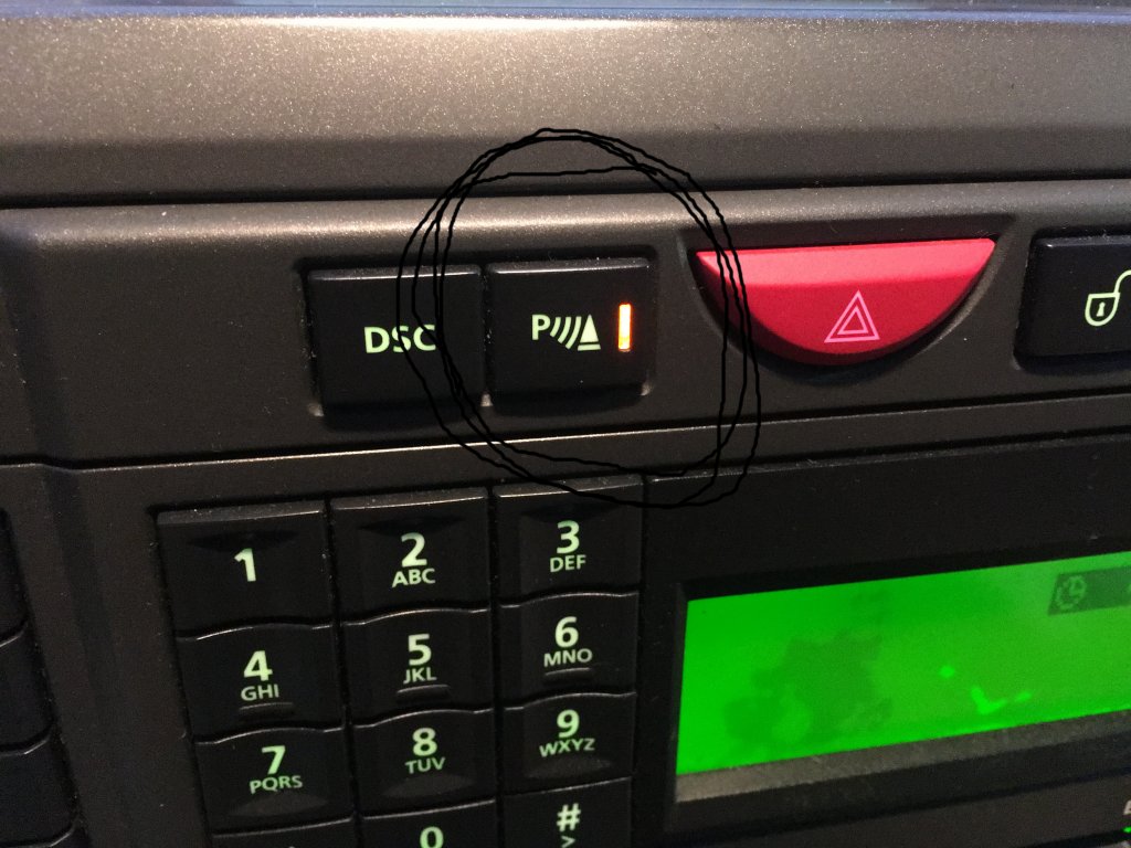

Can someone tell me what this is? It blinks till I push it, then it goes off, but that seems kind of pointless, yes? I actually do have the Owners manual for this HSE, yet I can't find the reason for the blinking button. Until I know better I am assuming it is the "You are peeing on a traffic cone" button

It's the park distance assistance function. Dude...you just seem like someone that doesn't want to do things the right way. You've been given good advice. If you choose to ignore it then you reap what you sow. I do hope you take heed and buy an IIDTool and use genuine parts and fix things as needed and not try to take shortcuts. It won't work....
