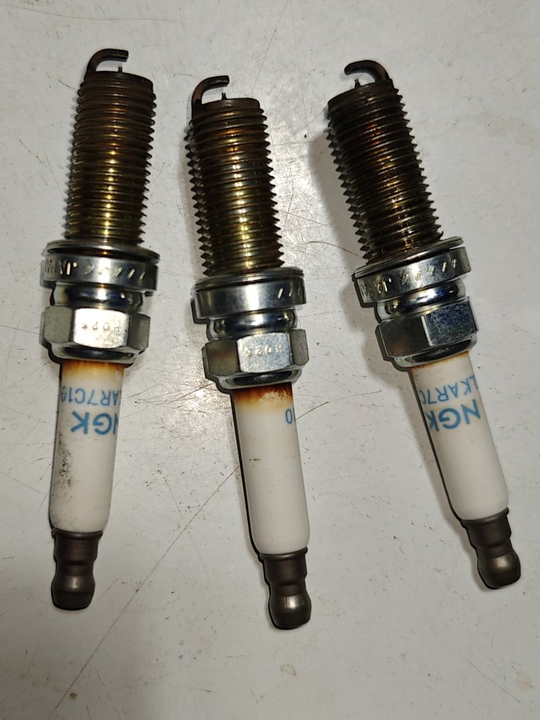

I was only able to get the passenger side bank of spark plugs complete today and will finish the rest tomorrow. The photo is of three of the plugs I removed. They seem worn but not bad. And they are the NGK 7C model versus the 6C that were originally used which tells me they were changed at some point. Any thoughts about what you're seeing? Could these be the culprit?

Hello, did you ever make any headway with this issue?
I'm getting the same thing, I believe. I have a noticeable loss of power and a roughness (feedback) I can feel in the pedal and steering wheel mostly at low speeds. It is negligible at 70 on the highway, and fuel economy seems to be better up there as well. I noticed it following an oil change. I was also due for a filter/fluid change on the trans and that offered no improvement. I also noticed maintaining or losing speed going downhill, unless I'm at a higher speed.
I get the same 32v sensor 1 on the iid tool, and the intake volumes seems close to one another.
