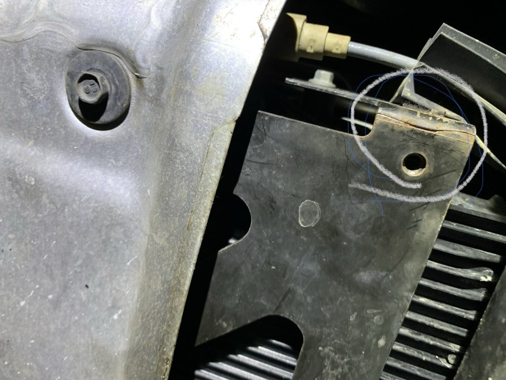

Anyone know what this plate is named. It's cracked and rattle is annoying. I went to remove it but saw some lines hooked to the sides so wanted to research it before I do more digging. It's underneath just behind motor so I am assuming its transfer case or trans type cover.

Part number: LR073535 transmission heatshield mounting bracket. Mine is cracked too and causes an annoying noise at low speed.
It's about $150
