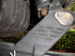

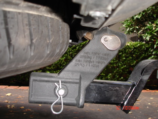

Could you explain further you comment about 'proprietary hitch reciever' and 'aftermarket hitches'? My LR3's factory towing package has 1) a frame attachment hidden behind a removable plastic panel on the bumber, 2) after removing the plastic panel you insert and secure the hitch receiver which is nornmally stored in a compartment inside the cago area, 3) the hitch receiver has a 2" square hole which accepts a standard 2" square hitch tongue, on which the hitch ball is mounted (the hitch tongues are aftermarket products which come in various size offsets so you can achieve a level trailer situation). As noted in previous posts, my hitch receiver is stamped "max tongue weight 750 lbs", even thought the manual says the max tongue weight is 550 lbs.

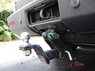

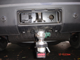

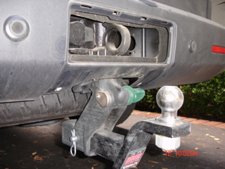

Can someone post a pic of their LR3 hitch receiver and their shank/ball?
I can't reflect on what the owner's manual says versus what the hitch receiver says. The #550 number is one that LR has stood by for years in their manuals. It is likely that they simply kept it. I'd love to hear clarification from someone that really knows what the tongue weight limit on the LR3 is. Is it #750 or is it #550? Anyone talk to anybody at LR about this?
I will say this; just because the hitch says #750, does not mean that there aren't other limits that LR is considering (suspension, transmission, etc,). I think it would be difficult for LR to void a warranty, however, if their receiver is stamped with a different number than the manual and someone relied on the receiver info.

I've got the pictures, but it won't let me paste/attach them to this thread. It says under "posting rules" that I don't have permission to post attachments. What am I doing wrong?
X
xray
Guest
Pics of hitch, etc.
Thanks mconnet. FYI, I downsized and uploaded.
