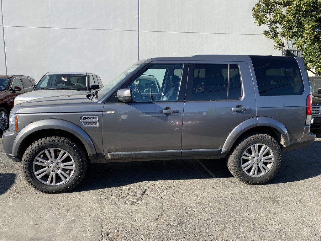

4 Arnott's and SYA kit are in transit, now I just need to make the tire decision. 255/65r19 Duratrac or 255/60r19 A/T 3. Leaning toward the Toyo's but I'd really like that extra bit of height and sidewall.
Before tires and labor I'm at just under $5K for the year so far.

The new struts, SYA kit and duratrac 255/65r19s are installed. I was supposed to pick it up today but they are having an issue with the rear suspension. You get a “clunk” you can feel when you go over any size bump. It feels like something shifting around.
The shop needs a bit more time to figure out what’s going on. So far they’ve been great, it’s only been there a few days. Must have patience.

For mine I just had to re-calibrate the suspension higher, it was too low. Ride is fine now. I'm still having stability control issues though and it's at the shop now being calibrated a little lower. They also messed up the alignment which may be causing some of that, too much positive camber. I think they did the alignment originally prior to changing the height which ******* it up.
