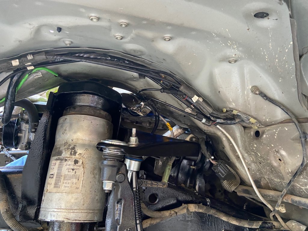

And another perspective for driver's side wheel well after rebuild and re-installation.

The newly painted and refurbed struts on newly painted mounts.
A local mechanic quoted me $7k to change all 4 air struts. Swear to god. He had $550 labor for each corner and Land Rover brand air struts all around. I'm so glad I didn't need to service them lol. I'm super easy on it off road. I drive it slow if its bumpy and the air suspension works its best that way. Its more comfortable too. A lot of guys like to drive fast and the LR4 can do it, but it costs money to drive fast off-road.
As an aside, in the first set of pics, the fender showed mud in the lower part. As you may know, if that isn't removed you'll likely have a rust hole there in the distant future.
Thanks @powershift -
Yes, (all) the mud is slowly getting removed and things getting cleaned/repainted (give us time!) I was frankly surprised how much stuff has accumulated everywhere in this thing...there are a lot of nooks and crannies which you only see when everything gets torn out. So rust prevention is coming!
That sound like a lot of money to do the struts.... A lot of folks are replacing these by themselves at this point (and you don't even need spring compressors!) You can do that job in a garage with just floor jacks and stands and it makes sense to work on those when you have to do the control arms / bushings - which is what I am doing. And those struts seem pretty tough and reliable so rather than replace, which isn't cheap, I opted to service. Thus the source of my question - are there any issues with serviced struts?
