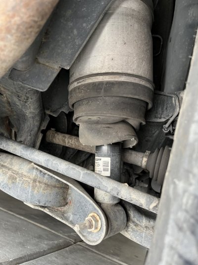

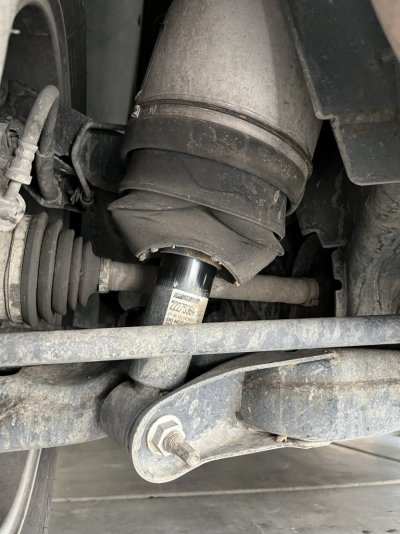

Thanks for the responses everybody. The pictures were taken while in the normal setting not off-road or access.
The only reason I asked is because I just bought some 265/65r18, Tuffant Wheels, and Xlifter and figured I may replace the struts while I’m installing the new wheels/tires. I want to avoid a failure off-road if I can….but while changing the oil today I discovered an oil leak coming from the front crankshaft seal….of course right after I bought the lift/wheels/tires. Now I’m debating on fixing the LR4 or selling it…. Smh.

2013 LR4, the rear air struts look like they may be bad. No codes or any abnormal lights being posted, car rides fine. Put the truck in high clearance mode overnight to see if it sags, but she held fine the next morning. Only thing I notice is that it looks like there is a very slight bit of negative camber to the rear. Car gets driven once a month.
Your thoughts on the struts…
I think they are ok if car works fine. mine looks this rough but still works as they should.
