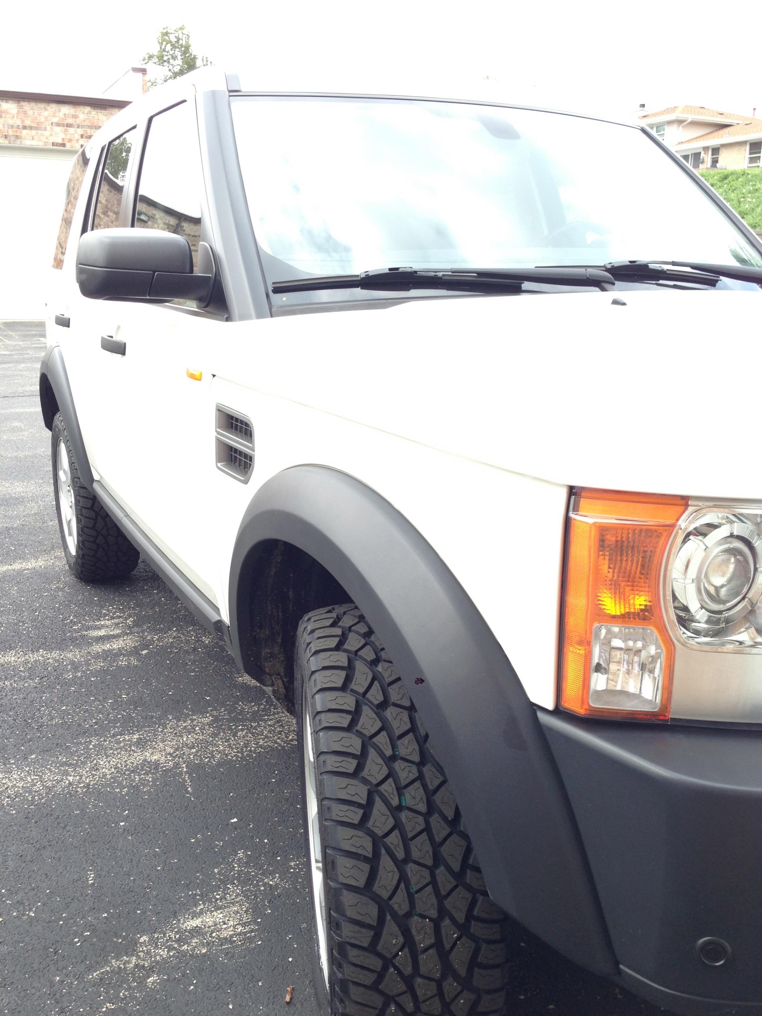

Diffs are done, transfer case is done and found a shop in Minooka, IL that is owned by an X-land rover service manager that is working on a quote for the transmission oil and filter change. I am going to use the plastic pan again because I don't know that I will own the vehicle long enough to do another transmission fluid change.
New tires are installed

They are low noise on the road. Have yet to off road with them. Just found out the rear differential has to be replaced. Boo. I changed the fluid about a week after picking up from the dealership and it was very dark and smelled burnt. A strange noise started a day or two before I changed the fluid. The fluid change did not help the sound. Took it to the dealership and they said the driveshaft bearing is going bad.
