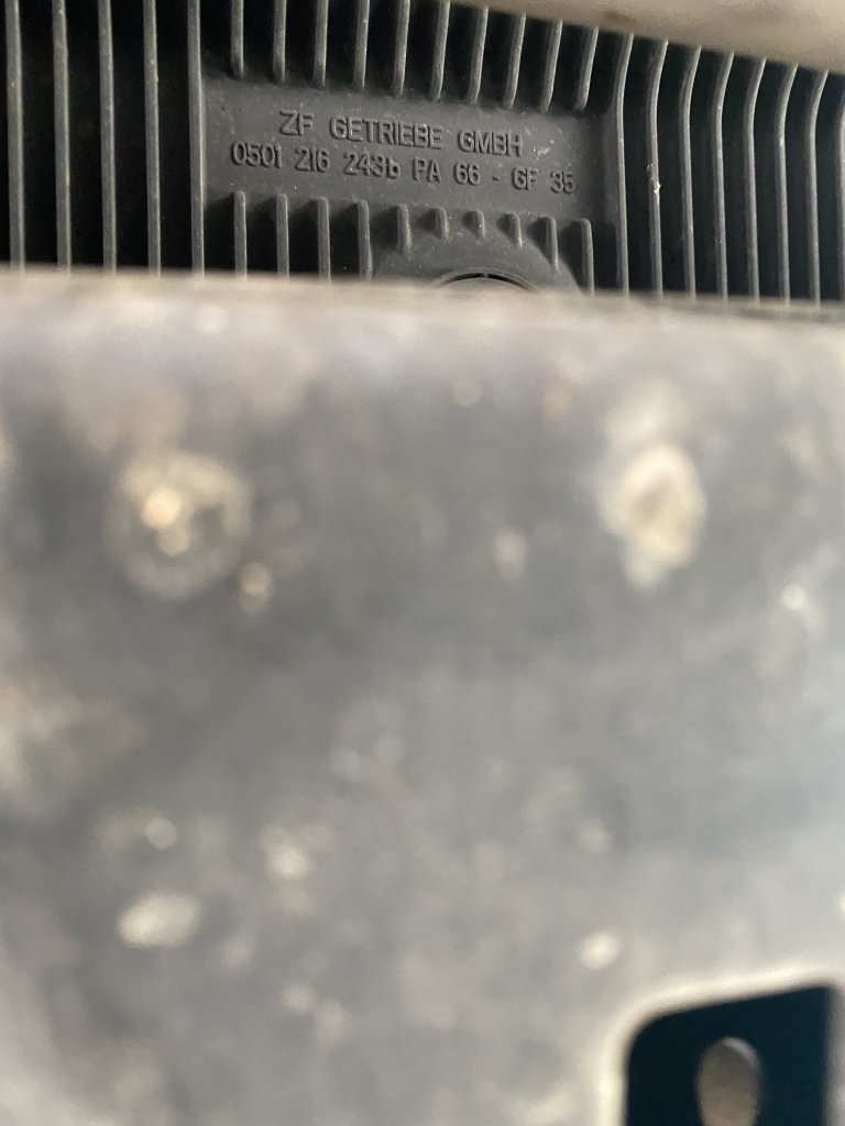

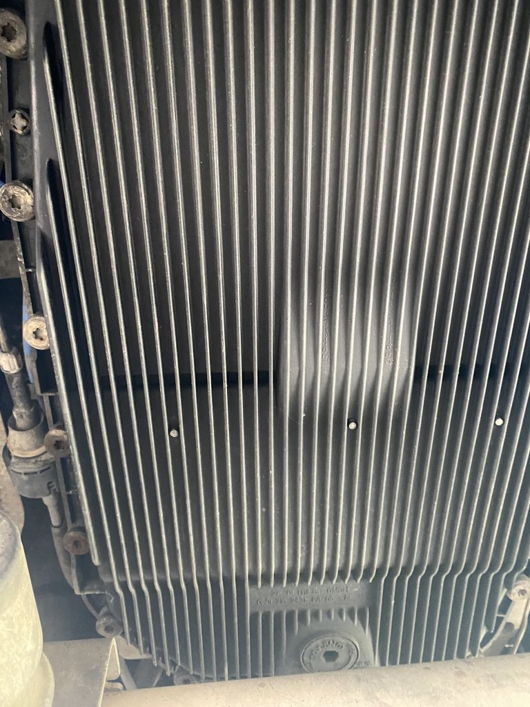

I’m guessing by the fins, material (aluminum I believe) and drain plug that I have an aftermarket pan.
Would my assumptions be accurate?

Looks stock to me, I also just went through this entire process of replacing all of the drivetrain fluids and transmission pan/filter. I found that RMEuropean had the best prices for fluids, they have all of them from the diffs, transmission to transfer case. You can do either LR branded or OE ones which I opted for. As for the transmission filter, the stock unit has a built in filter and you have to basically break it to get it out of place, I'll find the origional forum for you on this as it's got tons of useful info - most guys(including myself) opt to change it to a solid steel pan with a replaceable filter for longevity and easier replacement down the line.
